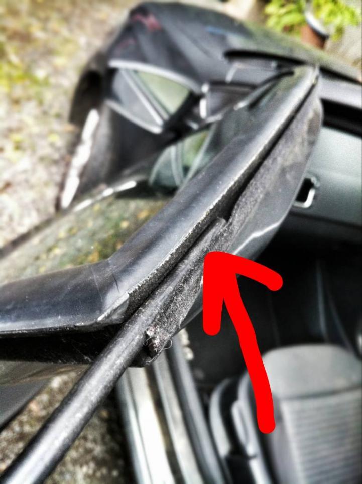

    Firstly, go to Bunnings (or rummage around your shed) and get yourself about 5 metres of ~6mm diameter irrigation tubing. If you have a choice, get the harder stuff, not the soft rubbery stuff.

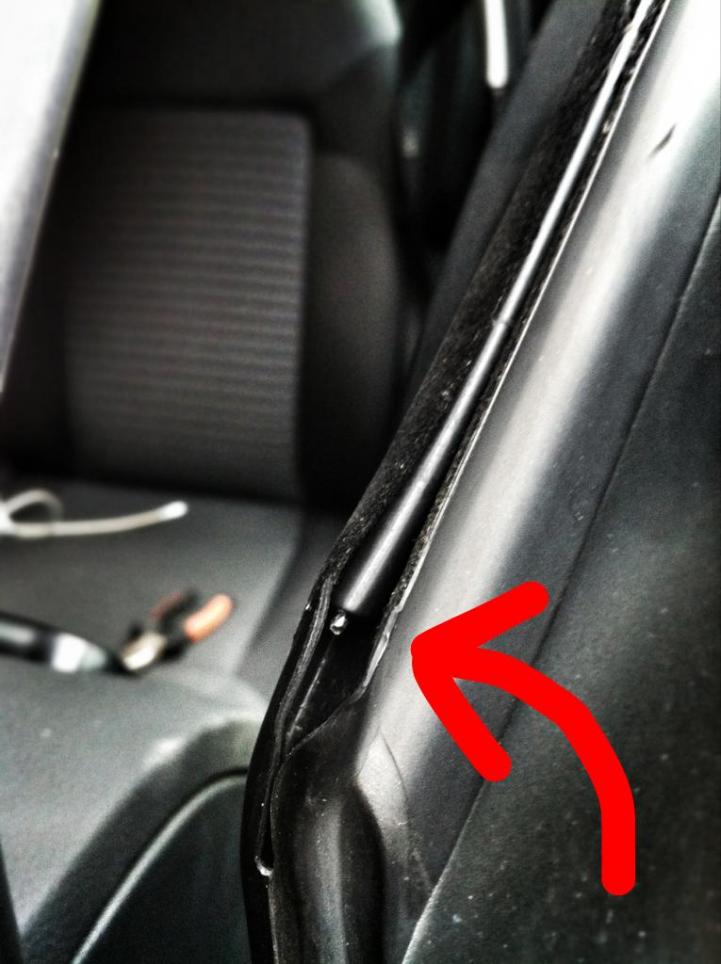

    Next, get one end of it and feed it down your top door seal, between the two strips of felt:

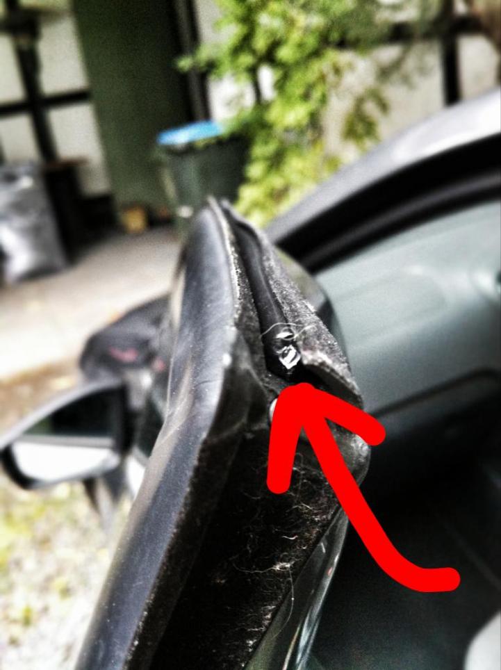

    Run it all the way to the end of the seal, then cut it to length:
    Make sure it all sits snugly, then close the door. You should notice that the door closes more tightly.

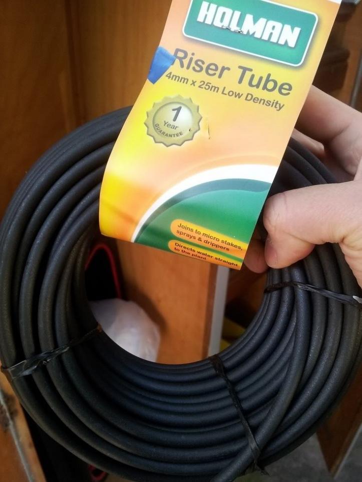

    Did this a few months ago and its worked well enough but the creaks are coming back. So 6mm may be the size to go, although the 4mm was a nice fit.
    I got the 4mm irrigation tubing. Cost me around $5 for 25m.
    And it was as simple as feeding the tubing through the gap between the felt and rubber.
    It's pretty much fixed the 95% of the creaking. A few here and there, but definitely not as noticable and prominent as before.
