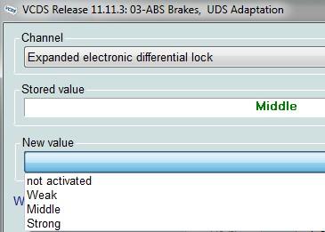

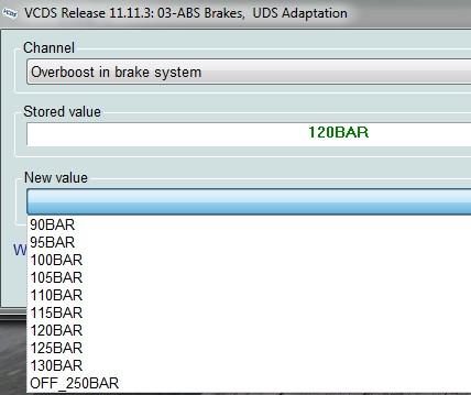

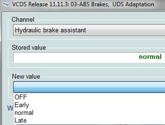

                        In response to my own post above, I dug around further and have taken some screen shots of what I see when I go into the 03 ABS Brakes area (which is where I think I need to be to configure Brake Assist and XDS. I've then gone into what seem like the most relevant adaptations to show the options available. I'd be really grateful if someone who knows what they are doing (unlike me ) could look at the snaps and point me in the right direction?
                        List of all options visible under 03 ABS Brakes - Adaptation:
                        List of options under 03 ABS Brakes - Adaptation - hydraulic brake assistant:
                        List of options under 03 ABS Brakes - Adaptation - overboost in brake system:
                        List of options under 03 ABS Brakes - Adaptation - expanded electronic differential lock:
                        Finally, if I click on the Long Coding Helper button, I get this error:
                        Any assistance on this and the post immediately above would be much appreciated.
