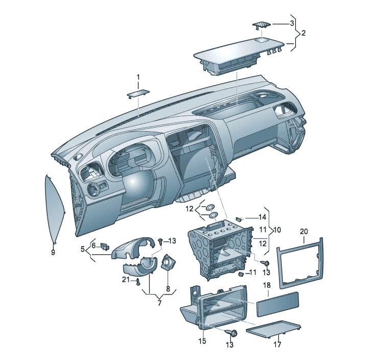

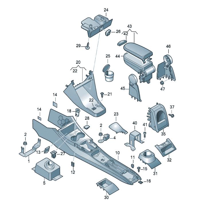

                        I've never done a Polo 6R before, but I'd usually start with popping off the gear shift surround and working my way up/forward (there is usually some screws in there). Other times you have to work from the radio or AC and back down. Trim removal tools are something most people will need at some point too:
                        Supercheap Auto is Australia's leading auto spares, parts and accessories retailer stocking a variety of car batteries, air filters, coolants and more online or in stores nationwide
                        This might help (although is probably for a LHD vehicle)
                        Probably don't need this one, but here you go anyway:
                          Thanks again Aaron,
                          I might give this a go eventually but it looks a bit tricky. Those diagrams are a big help though

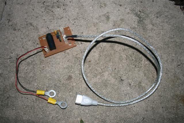

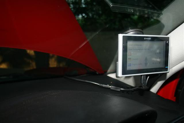

                            This is my solution for my MK4, home made 12v to 5v regulated power supply, with 3 headers.
                            I have one line to the Navman, and another to a micro USB in the dash cubby for phone charging.
                              Looks good!
