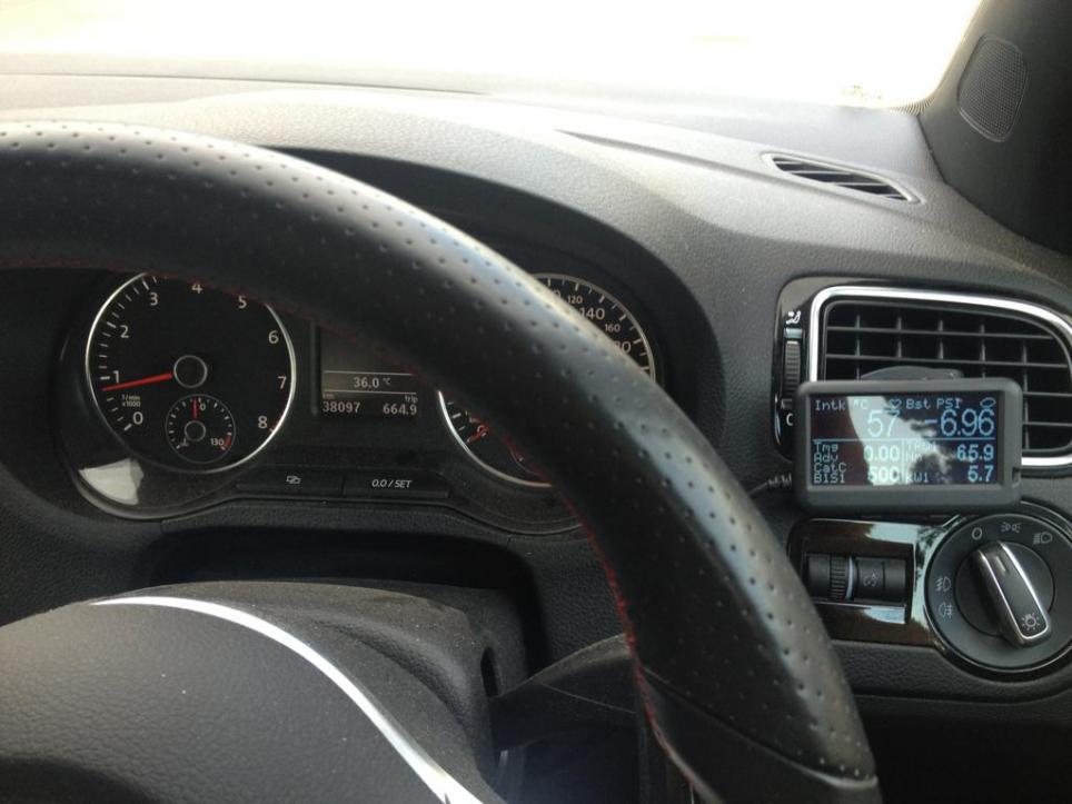

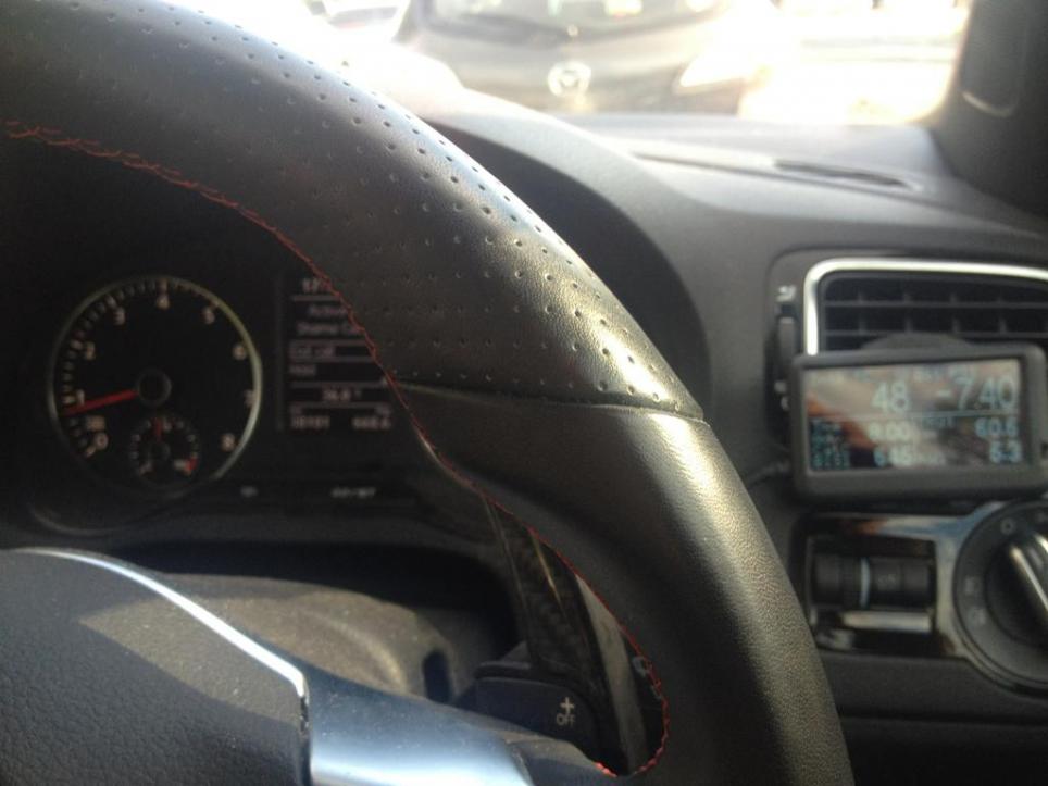

                If you speak to the uk guys, HP are "stupid" with their stepped core design but it's no surprise that's what they say when APR UK are developing their own intercooler. As I pointed out to them, the proof is in the dyno graphs and real world performance in Australian conditions. A few of the local 9n Polo Gti owners have swapped out their forge intercoolers for Seat Sport ones instead, speaks volumes to me. The twintercooler option seems interesting to me because I logged temps with the factory cooler and they were horrendous after a repeatable 30km, 100kph run. On an 18 degree day I saw temps up around the 40's. Forge then take that air, send it around a corner into another cooler (which blocks off more radiator space) with no evidence in relation to pressure drop/vs flow etc.
                Look, it's up to you but fuel economy gains aren't going to offset the purchase price. It's going to give you better heat dissipation after heat soak that's after 5 mind idling...
                That's after 1 km at 60 kph.
