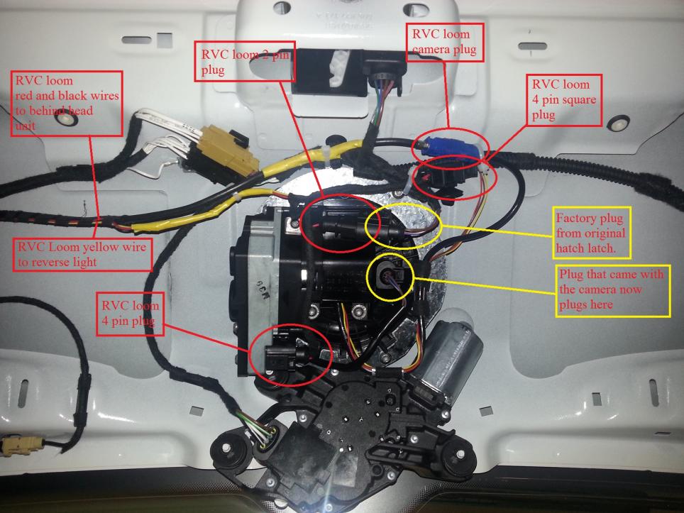

      Hi, I want to mount the VW Golf Rear View Camera in my VW Polo 6r, but I read the support of the rear window wiper must be cut.
      Vw-rvc-wiper-mod-remove-leg-1 : Polo 6R Rückfahrkamera! So knapp vorm Ziel : VW Polo 5 : #205293907
      Don't you cut that support? don't bangs the RVC to support of the rear wiper? Have you a photo of RVC on?
      Sorry for my bad English
      • #63
        No - you do not need to cut the wiper mount.
        You can see it clearly intact in Staz's photo

          you dont need to cut anything... we wouldnt have done it if you had to. mine and staz's pics should show what you need to know inside the hatch.... I have no idea why that guy cut his motor mount, but it is a bad idea.

            here is one of my pics... you can see the bracket / mount missing eachother here...
