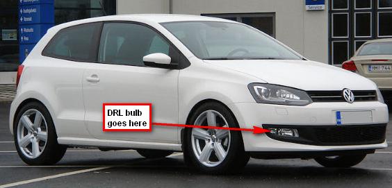

    I'm keen to replace the OEM standard filament bulb that is used for my daytime running lights (DRLs), with an LED bulb. Just to be clear, as there are various flavours of DRL on the Polo, this picture shows the bulb I'm referring to:
    I've tried using this LED bulb, but it does not light. I've tried the bulb both ways round in the socket, but no joy. I don't get any errors on the dash and reinserting the original bulb works fine. I've tested the LED bulbs with a 12v circuit and they work fine.
    I don't want to go the expense and hassle of a full LED retro-fit, I was just hoping to do a simple bulb swap for the desired effect. Can anyone think why this would not work and what a solution might be? If LEDs aren't an option, are there any bright white conventional bulbs that could be substituted for the feeble yellow affair that is fited as standard?

                1. My standard NZ-spec car has a light assembly below the front bumper, per my photo, that comprises 2 bulbs within the one assembly. The inboard bulb (nearest the radiator) is a fog light; the outboard bulb (nearest the wheels) is the DRL, currently populated with a bog-standard filament bulb (21W from memory). With the ignition on, the DRLs are illuminated. When the sidelights or headlights are illuminated, the DRLs are extinguished.
                2. The LED bulbs I bought don't mention being CANBUS compatible, so I suppose the problem may be as simple as that. From what I've read on the briskoda forum I use regularly, CANBUS is not as fully implemented in the Polo 6r as it is for some VAG cars, hence I have been able to swap the number plate lights on my Polo for LEDs without any recoding or dashboard error (unlike my Skoda, which does throw an error). I would have thought that non-CANBUS bulbs would at worst throw a dashboard error, but instead they just don't light up, no warnings, no errors, no light .
                Given the existing functioning lights are coded to work already, surely there wouldn't need to be any coding adjustment, would there?

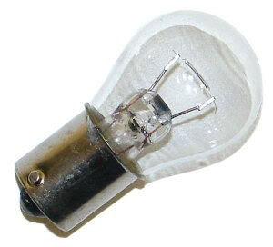

                    Remember - I'm not talking about changing the fog light bulb; I'm wanting to change the DRL bulb. I'm not sure what bulb style is used by the fog light, but the DRL bulb is an 1156 (bayonet style) and looks like this:

                      I think you inadventantly answered your own question. The 6R has 2 fundamental systems with many varients of them but we will just narrow it to 2 for arguments sake. There is GTi canbus and regular 6R canbus, the 6R is much more integrated whereas the regular 6R system is not. If you are not getting bulb-light errors on the dash, this does not mean that the light isn't throwing an error. I would start by getting your hands on some properley specced LED bulbs from somewhere like hids4u.co.uk and see if these work for you.
                        Ahhh ok. My Polo does not have this in the fog light part so that's where I was getting confused.
                        Sorry buddy I can't help ya then. However if the connection is similar to the one posted above then I can't see why It wouldn't work?
