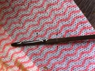

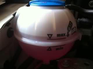

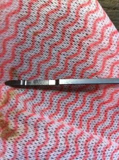

    I had my 2011 Polo 77TSI serviced on the 21st of Jan. Stupidly, I did not check the oil level until now and noticed that the oil level is way past maximum(checked it warm, 30 min after short 10 min drive). Oil on dipping stick shows its about 10mm above the bend and 20mm above the last dotted line. The manual states it should not exceed the maximum point. Its not clear what exactly the max point is as the manual shows a different type of dipping stick but from what i gather I think it exceeds the very maximum point by 10mm. I haven't had any issues for the past month and i've done 1200k's since. Should I be concerned about this? Could that level do any damage? Should I raise this with my dealer? I noticed they also overfilled my coolant reservoir too. Pics below. Thanks
    Bare stick for Reference:
    Dipped:
    Coolant:

    If your dealer caused this then yes I would definately bring it up with them.
      * * * Ensure the vehicle is on level ground when checking fluid levels. * * *
      Engine oil - for 1.2 l 77 kW TSI
      The engine should be at its nominal operating temperature before checking the level.
      After shutting off the engine, wait at least 3 minutes so that the oil can flow back into the sump.
      The MIN range is the smooth region below the rough region & above the lower bend.
      The MAX range is the smooth region above the rough region & below the upper bend.
      There is a danger of damaging the catalytic converter if the oil level is above the MAX range.
      Coolant
      The level must be between MIN and MAX when cold.
      However, it is normal for the level to be slightly above MAX when hot.
      You should certainly raise the issue with the dealer.
      And while you're there, you should check the oil capacity of your engine.
      1.2 l 77 kW TSI engines manufactured up to May 2011 have a oil capacity of 3.6 l, whereas those built from June 2011 have an increased oil capacity of 3.9 l.
      It is possible they may have overfilled by misidentifying your engine.
        Over filling the oil can cause damage. I would take it in and get them to drain some out (or do it yourself, but it would be messy). Coolant is not so harmful at the level in your picture, so I wouldn't be concerned about that, but I would still mention it to them in the hope the service guy gets a talking too to stop in happening in the future.

                guys i went in there today and spoke to a head mechanic, he said they do purposely overfill them however he said mine was overfilled by 3mm. He said that it wont do any damage. He said that these cars have a high oil to fuel consumption. He said I wont need a top up obviously. Whats the purpose of the manual then seriously!!!
