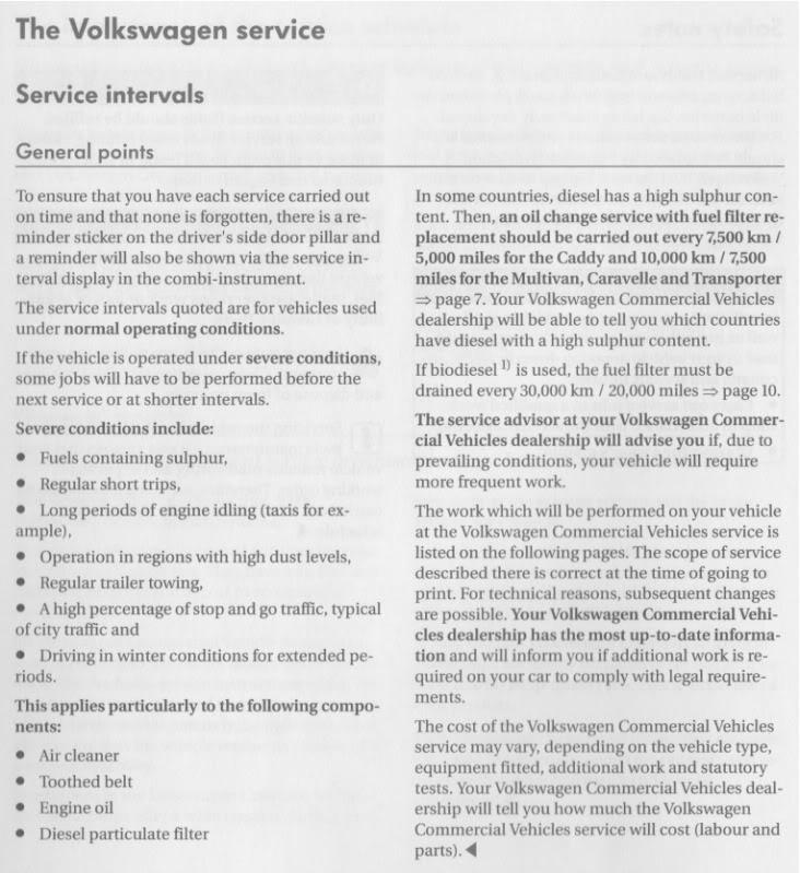

The manual looks like this for a diesel:
The extra dust isn't good for the air cleaner.
Short trips aren't great for the oil as it doesn't get up to temp, same issue for the DPF not being able to regen properly if it doesn't get heat into it (from memory it's 15 minutes + and 70+ for it to work properly).
The belt... well I don't know about that one, but I'm sure someone can chime in
