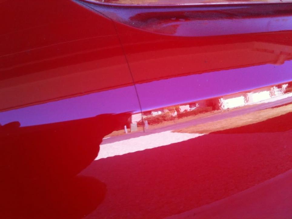

                              Here is what it looks like You can really only see the edges in the pics
                              This is one sill Done from up under rubber to right down underneath
                              [/IMG]
                              This is L/H end of rear bumper down down to the bottom of the shiny spot with leftover piece I had
                              This is R/H end of Passat bumper
                              Drivers Door sill Passat Is in two pieces as sill strip is separate on this model
