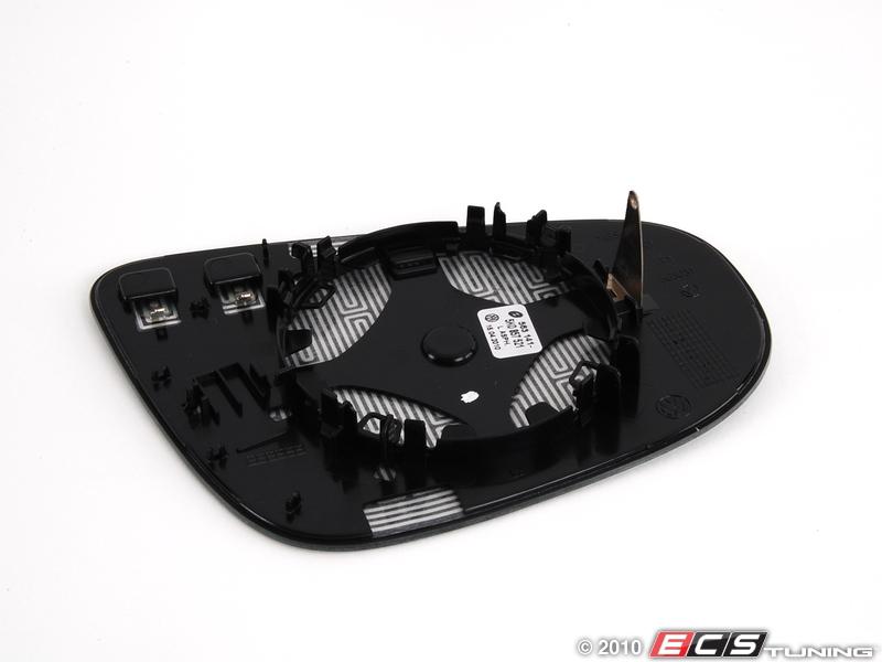

                            Not to my knowledge. They just come on. I doubt anyone would feel any actual "heat" of the couple of strips behind the mirror
                              According to the owners manual of my MY11 Golf R, the ambient tempurature has to be 20 degrees C or below for the heated mirrors to function.
                              They initially operate at maximum power, then after a few minutes they'll adjust based on the ambient temp.
                              You can see the heat element on this picture:
