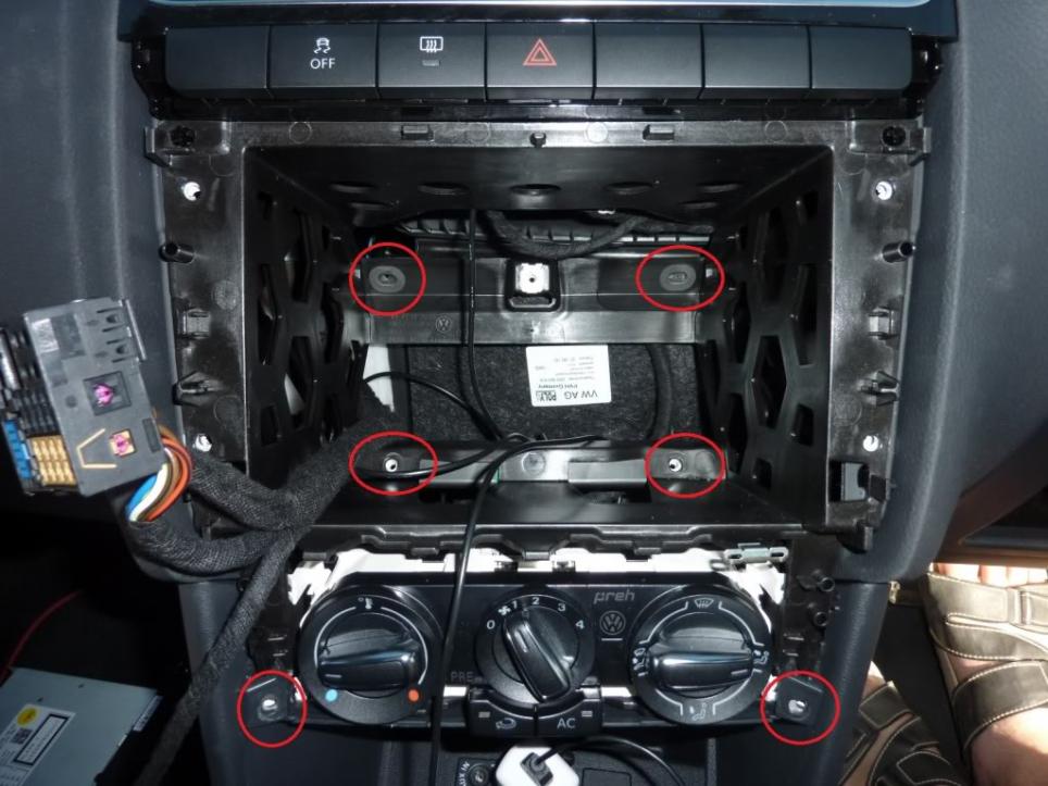

    After removing the fascia, you need to remove 4 screws that hold the radio in
    [IMG][/IMG]
    Removing the radio is easy, I did find removing the antenna connector a little tricky.
    Hint for noobs:
    Make sure you remove any CD BEFORE you unplug the unit.

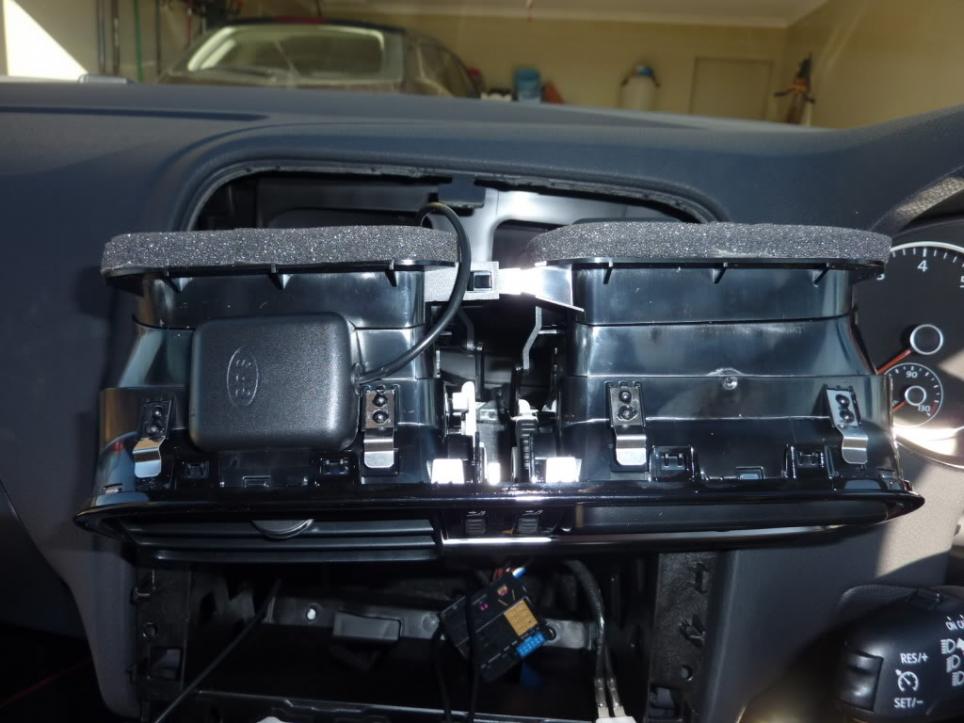

    To install the GPS antenna, you'll need to access the air con vents.
    This is a little tricky to work out.
    The air con vents are held in by clips and the audio "cage".
    To remove the vents, you need to remove the fascia around the air con controls at the bottom. This is simply clipped in, so take care and slowly remove the fascia with a trim remover tool.
    There are 2 screws holding the air con controls. Undo these and the 4 screws inside where the audio sits.
    After you have done this you can pull the audio cage forward, which will give you enough wriggle room to pull the air vents out.
    Once you have the vents out, you can thread the GPS antenna cabling down through the centre section of the vent into the audio cavity and place the antenna itself on top of one of the vents.
    Then the key is to make sure that the wiring doesn't get jammed as you first put the air con vents back in, then reinstall the 6 screws for the audio cage, the air con control fascia and then the 4 screws for the audio and then finally snap the audio fascia back in.

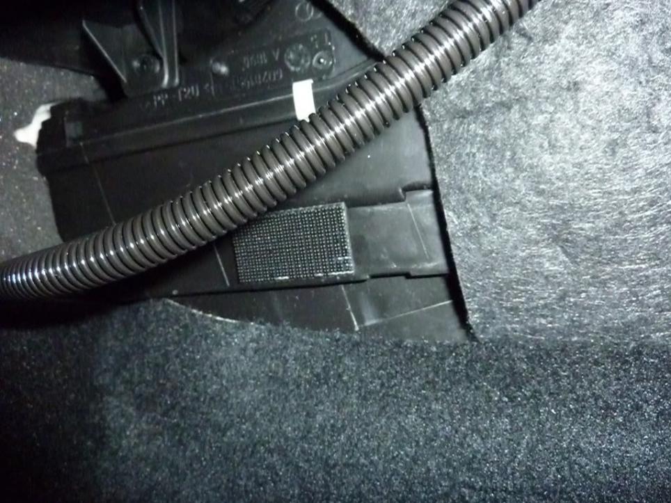

    The first thing I did was look at where to situate the actual bluetooth unit.
    I wasted a fair bit of time looking at installing the unit behind the air con controls.
    What I worked out was:
    1. If you have manual air con controls then you can only install the unit under the seat (I chose passenger)
    2. If you have the semi auto controls then you can install behind the climate control unit
    Anyway, I chose to put the unit under the passenger's seat.
    I have a GTI, so it comes with the seat drawers, so I needed to pull the unit out of the protective polystyrene case. I bought some velcro tape from a $2 shop and attached 3 strips to make sure the unit doesn't slide around.

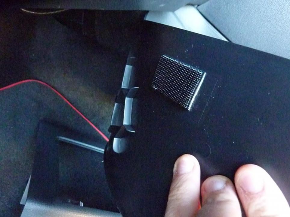

    To route the wiring, you'll need to pull the panel on the centre console off.
    This comes off with a little bit of pressure.
    You can see that it is held in place with a kind of pressure fit velcro.
    And another view

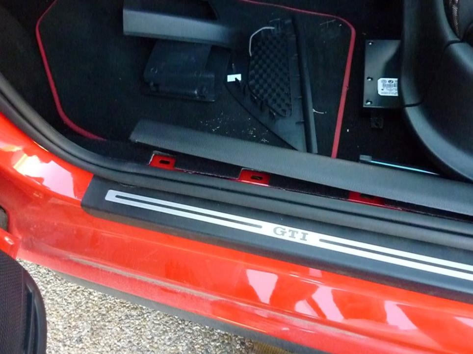

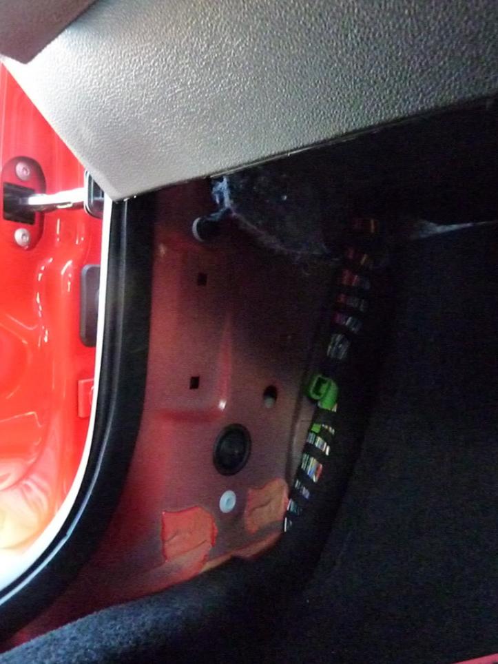

    Once you have the panel removed, pull most of the cable which connects to the Bluetooth unit through that gap and then you'll need to remove the passenger side kick panel.
    To do this, remove the little area reserved for the emergency pncho and then pull with reasonable force on the panel. It is attached with two plugs and will pop out easily.
    Then finally, you'll need to pull up the scuff panel to give you the most amount of room to play with.
    Once you do this, you'll need to get your hand in under the carpet and pull the cable through, under the passenger seat. You'll notice by felling around that there is a join in the carpet between the front and the back area directly under the passenger seat. Pull the cable through to here and then ensure that the cable going back to the head unit goes directly to the centre transmission tunnel and back to the head unit.
    No pics here but it's simple to do.
    The remaining thing to do is plug the cable into the Bluetooth control unit, stick down with velcro and then reinstall the scuff plate, passenger kick panel and centre transmission tunnel panel.
