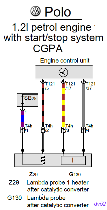

    I don't have a wiring diagram for this MQB platform Polo - but just to show how these O2 sensors are arranged - below is a picture from the earlier model Polo (which I made for another forum member)
    The set-up on your Polo will be very similar to my pic albeit the wire colors and pin-outs will be different.
    So, as you can see - the 4 x pin device contains a heater and the cell (called a Nernst-cell) The post cat sensor is not used for measuring - it's purpose is diagnostics. Anyway, I suggest that you grab a multi-meter with good set of test-leads and measure the resistance of the heater terminals.
