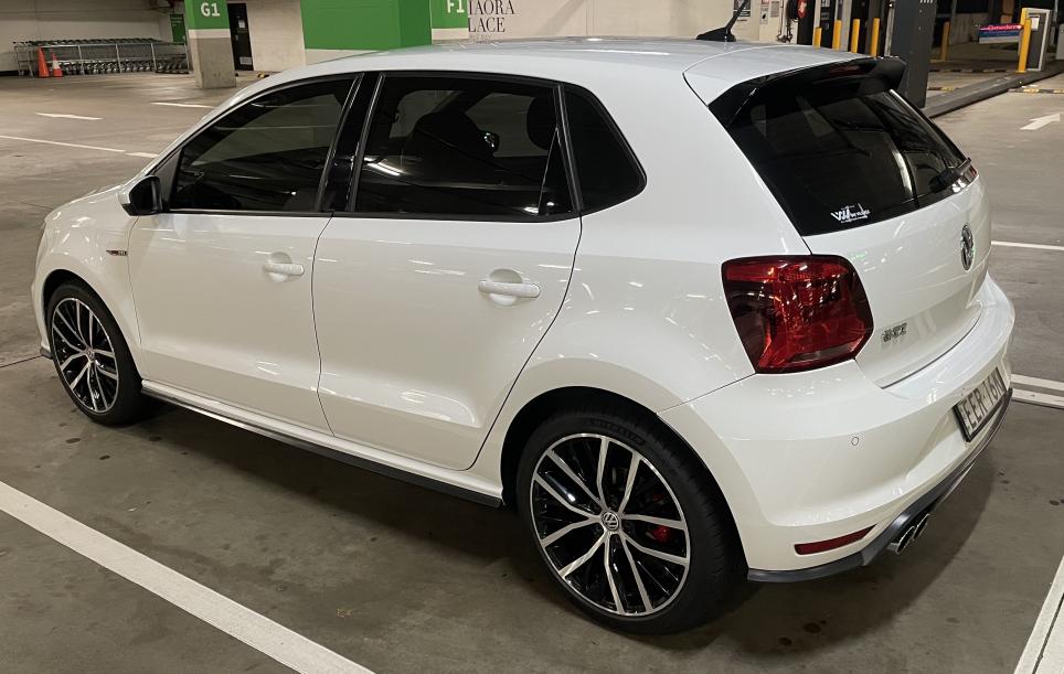

    Hey guys,
    It's time to replace the front brakes on my Polo GTI.
    I've been doing a lot of reading and there's lots information and options online, however I'd like some first hand feedback from experiences on people's cars.
    The car is still stock and hasn't been out on track (yet), so I'm looking for a spirited street setup rather than a track upgrade.
    All opinions appreciated
