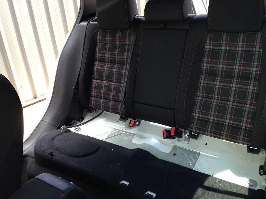

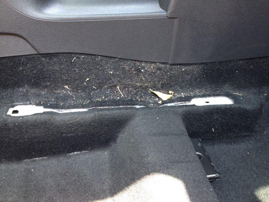

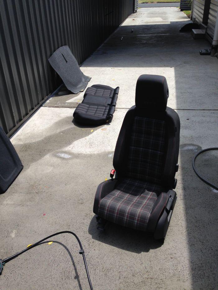

      I removed the front seats from a 2011 Golf GTI for exactly the same reasons as you when i first bought it (2nd hand in 2014). Just disconnect the battery, and then after you have undone the 4x bolts holding each seat in place, just unplug the few connectors under the base of the seat (airbag, seatbelt sensor, etc) and pull the seats out. If you just want to vacuum under the seats you may not need to physically remove them - simply leaning them back once unbolted may suffice.
      No special plugs or anything - easy done.
