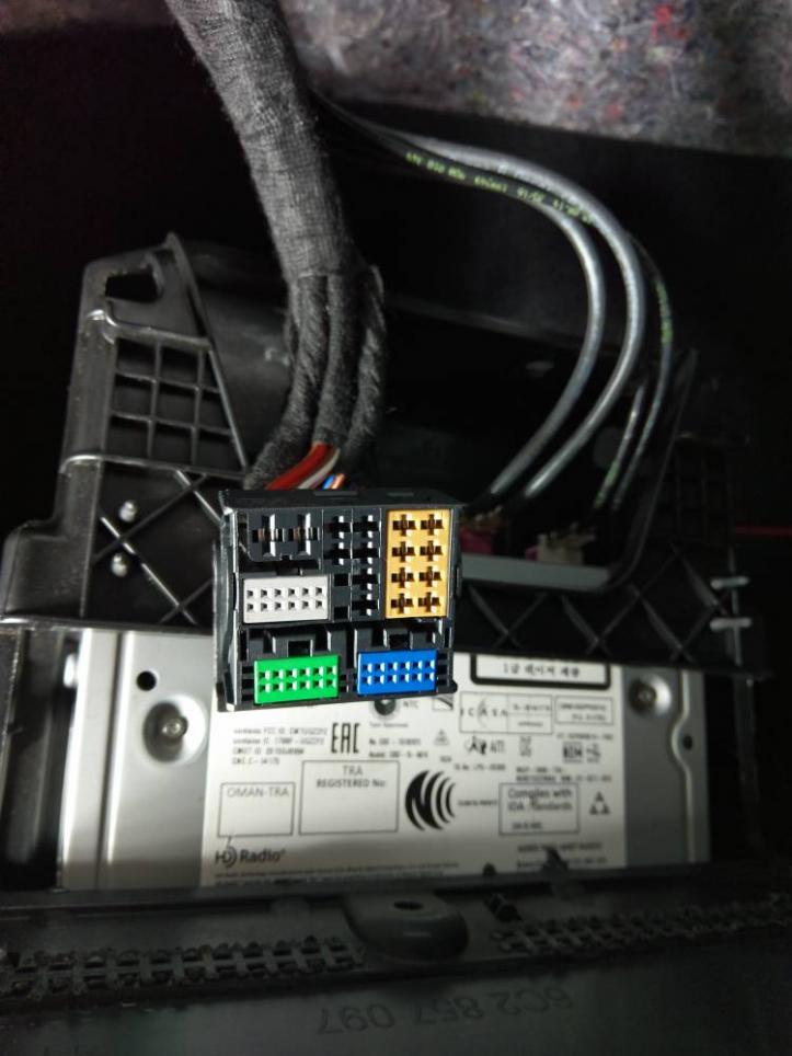

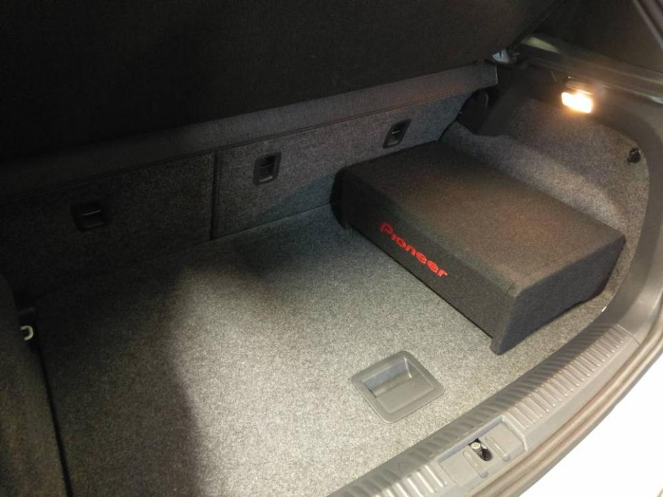

      So yep I've done a 5 channel amp install with a small subwoofer patched into the oem headunit with a loom I bought and modified. It's completely reversible as I didn't hack into the headunit wiring.
      Here some photos. Made a false floor for the amp in the boot.
      Sounds great and oem speakers have responded well to a little more power quite well. Subwoofer fills in the low end.

        That's clean as. I've just ordered the wiring kit I need to install a subwoofer my mate will be lending me. If it works out i'll go out and buy my own.
        With the 5 channel amp, did you use 3 sets of RCA's? How did you tap into the speaker outlet? Did you use speaker level output converters?
        Would be good if you can send a list of what you used. How did you make the false floor? With mdf and then carpeted?
