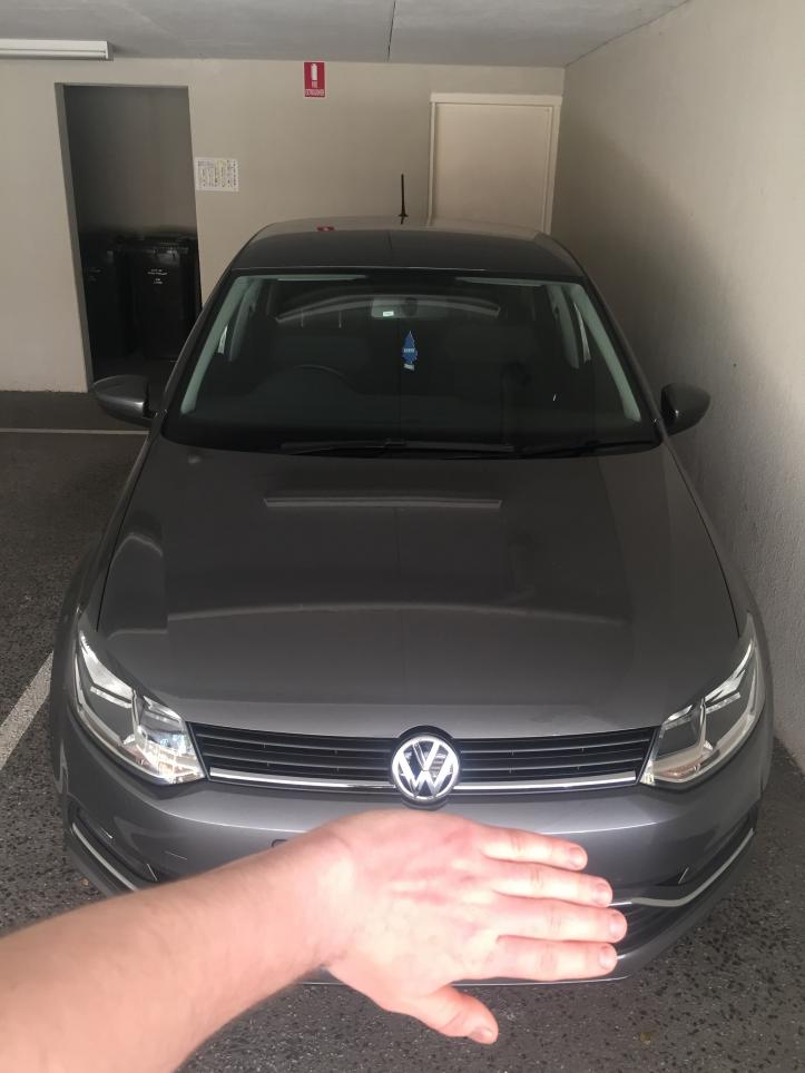

    Fast forward to Sunday. While cleaning my car I noticed this:

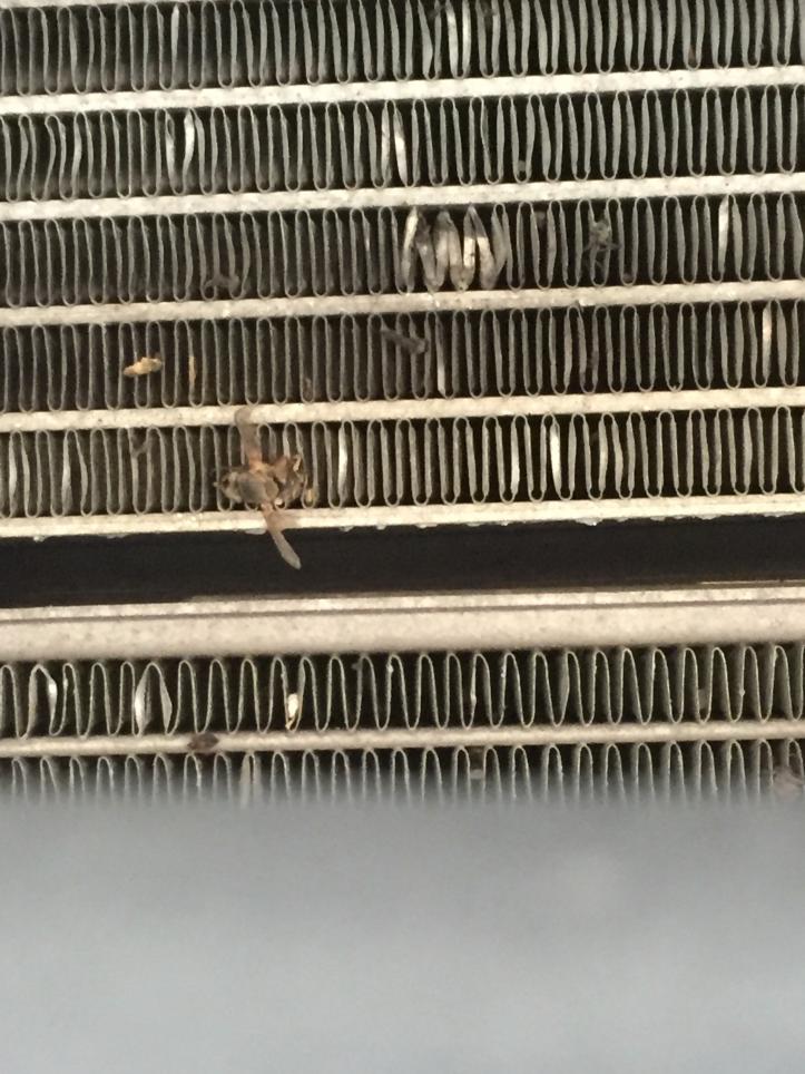

    This is presumably why I had been contacted, the skid plate had been left off the underside of my car. Now this irritated me considerably, but again, I can understand that mistakes happen so I wasn’t about to go ballistic. What I found next however really got me though. Close inspection of the front of the car showed two things, firstly the bumper had not been removed (evidenced by leaves and crap sitting in the area at the front of the condenser, which have been there for several months, which would have been removed if the bumper was taken off). Secondly, I noted the impact damage presumably identified in the inspection:
    While I am not a refrigeration expert, I know how they function and was extremely doubtful that the damage seen was the cause of the leak. Further to this research showed that the TX valve is located at the firewall in my car, and it would be impossible for a stone to damage it, and almost impossible for a damaged condenser to damage the TX valve. This in itself raises issues with the diagnostic service and thus the fee paid, as well as the quote given. If the TX valve actually needed replacing, it should have been done under warranty, and further to this the diagnostic fee probably should have been waived as there was an identified warranty issue.

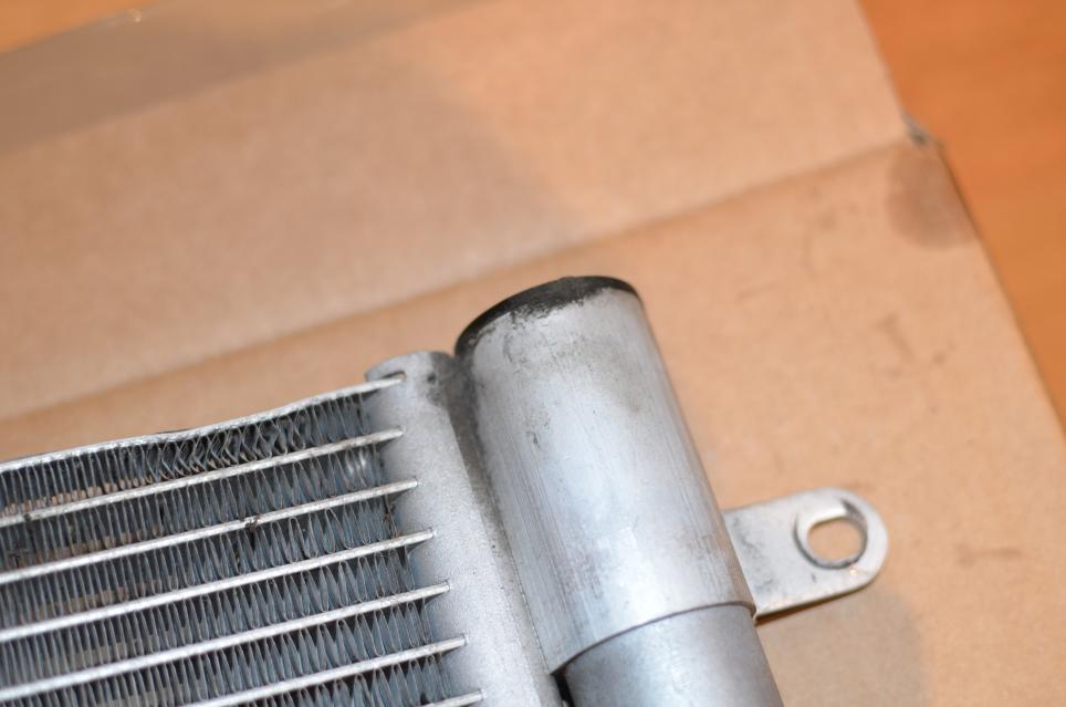

    Extremely (I could fill a page with expletives) irritated at this point I left in peak hour traffic to get to work on time. In a crackthe***** moment I booked the car in to have the condenser replaced the following week at my mechanic. Firstly, the TX valve was perfectly functional (!!!!!!!!!!!!) and post removal inspection of the condenser showed that it was extremely unlikely the leak was caused by stone damage, and PAG oil residue (for those that don’t know, this is a lubricant in the refrigerant) on the RHS and centre of the condenser suggested this was where the leak was coming from. Further to this there was impact damage to the top RH corner of the condenser and this can only be explained by a fault prior to or during initial installation (as it sits behind an intrusion bar under the bonnet, and this kind of damage would require a significant impact, something that this car has never seen).
    Seeing red, I called the service manager at the dealer and arranged to talk to them the following day in their office. I refused to discuss the issue on the phone as I wanted to show them the condenser in person. The meeting was a bit of a joke really, the manager was rude, arrogant and dismissive. It was only at the point where I put the condenser on the desk in front of them and highlighted the evidence that some reason/respect was returned to the conversation. I was left in the managers office while they went to discuss with the mechanics, and was told that photos were taken during testing, however these have never been provided. While falling well short of admitting fault the manager did agree to retest the condenser. I was also finally given an apology with regards to the indisputable screw up that was the lack of skid plate. Later that afternoon I received a video from the managers phone, that while blurry because of compression, was able to identify the location of the leak. Comparing the location to photos I retained of the condenser showed that the leak was in the central region of the condenser as demonstrated in the photo:

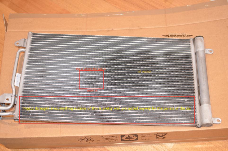

    My copy of this photo is 16MP, taken with a quality camera, in good light, with a good lens on the morning of the meeting. It very, very clearly shows a lack of damage to the condenser in the region of the leak. I spoke to the manager again this morning, and firstly admitted that the leak was in the central region not on the RHS as asserted by me, but reiterated that my claim was not affected in anyway. The leak is in a region free of damage (and actually sits behind the intrusion bar when installed in the car) and as such the condenser should have been warrantied. The manager is aware that I am seeking, (and will be receiving) a refund for the defective service provided by their workshop and also a reimbursement for the full amount of the replacement condenser that was installed as a result of this service. As of right now, I am still waiting on a resolution, but I’m pretty confident in a favourable outcome, even if that means escalating the issue through VW, CAV, the ACCC and VTAC.
    So what to take from this very, very verbose rant:
    If you find your car AC not working and it is under warranty, make it abundantly clear that you expect any assessment to include the removal of the front bumper, and you expect photo or video evidence of the condenser leaking at a point of stone damage. Further to this, make sure you thoroughly inspect the condenser yourself, not all of it is visible with the bumper installed, but a fair chunk, and that which is exposed to impact is. If you see a dirty great big hole in a refrigerant core, don’t even bother attempting to get it warrantied as it is not going to happen. I am writing all this, as I suspect that unfortunately many workshops may take the easy route, because warranty paperwork sucks, and will just claim stone damage if there are any bent fins on the condenser. This is reprehensible conduct in my eyes and I hope to prevent in from happening to anyone else. Also, if you feel you’ve been taken for a ride, and have evidence to support your claims, you have the protections of Australian Consumer Law on your side, in particular, your right to expect a refund for defective goods/services and also a right to expect reimbursement for reasonable costs associated with rectification of a defective service.
    Lastly, shop around. It was cheaper to pay the dealer $220 for a diagnostic fee and take the care elsewhere for condenser replacement than to pay them their quoted fee of $1260. Despite what a dealer may say, you are not restricted to use dealer workshops in order to maintain the warranty on your car (and in most cases, any inferences as such are heavily frowned upon by the ACCC).

        My copy of this photo is 16MP, taken with a quality camera, in good light, with a good lens on the morning of the meeting. It very, very clearly shows a lack of damage to the condenser in the region of the leak. I spoke to the manager again this morning, and firstly admitted that the leak was in the central region not on the RHS as asserted by me, but reiterated that my claim was not affected in anyway. The leak is in a region free of damage (and actually sits behind the intrusion bar when installed in the car) and as such the condenser should have been warrantied. The manager is aware that I am seeking, (and will be receiving) a refund for the defective service provided by their workshop and also a reimbursement for the full amount of the replacement condenser that was installed as a result of this service. As of right now, I am still waiting on a resolution, but I’m pretty confident in a favourable outcome, even if that means escalating the issue through VW, CAV, the ACCC and VCAT.
        If you find your car AC not working and it is under warranty, make it abundantly clear that you expect any assessment to include the removal of the front bumper, and you expect photo or video evidence of the condenser leaking at a point of stone damage. Further to this, make sure you thoroughly inspect the condenser yourself, not all of it is visible with the bumper installed, but a fair chunk, and that which is exposed to impact is. If you see a dirty great big hole in a refrigerant core, don’t even bother attempting to get it warrantied as it is not going to happen. I am writing all this, as I suspect that unfortunately some workshops may take the easy route, because warranty paperwork sucks, and will just claim stone damage if there are any bent fins on the condenser. This is reprehensible conduct in my eyes and I hope to prevent in from happening to anyone else. Also, if you feel you’ve been taken for a ride, and have evidence to support your claims, you have the protections of Australian Consumer Law on your side, in particular, your right to expect a refund for defective goods/services and also a right to expect reimbursement for reasonable costs associated with rectification of a defective service.
        Lastly, shop around. It was cheaper to pay the dealer $220 for a diagnostic fee and take the car elsewhere for condenser replacement than to pay them their quoted fee of $1260. Despite what a dealer may say, you are not restricted to use dealer workshops in order to maintain the warranty on your car (and in most cases, any inferences as such are heavily frowned upon by the ACCC).
