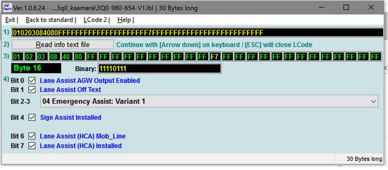

                  edit: I've loaded the label file from the link above into the long coding helper application - but it's not helpful in identifying the pertinent Bit for TJA. Here's the Lane Assist Byte for A5 (take no notice of the code-string in the picture- I just used random numbers):
                  As I said above, I suspect that we will need the with/without code-strings to make sense of this matter
