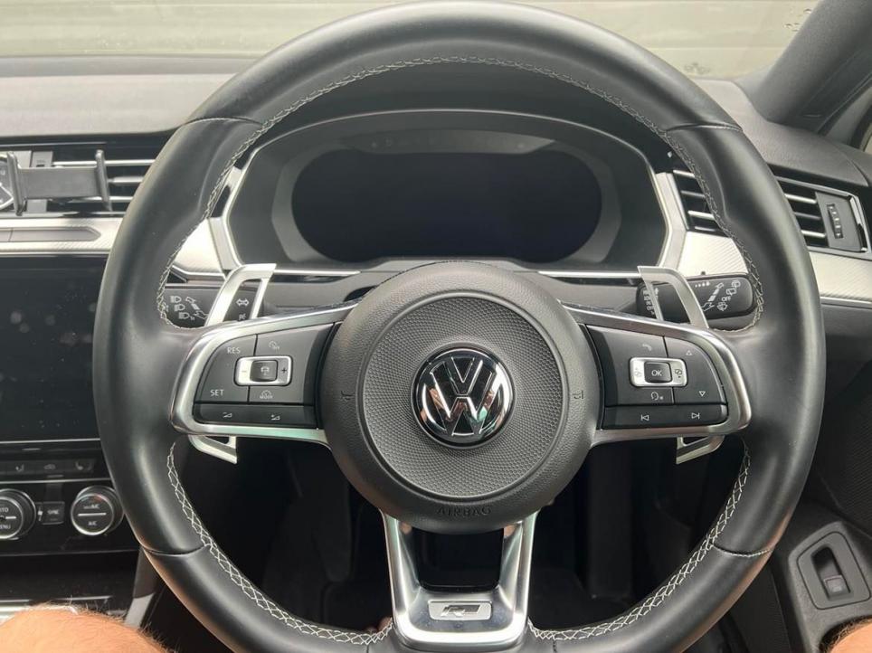

        Was your paddle shifters stickered on or replacement of OEM shifters?
        Any photos of them?

          Full alloy replacements from Aliexpress for about $20 - there are lots of different types. Some apparently fit a bit loosely but mine are solid. I bought this design as they have a hollow centre and don't obscure the wiper and indicator stalks. 5 minutes to install.
