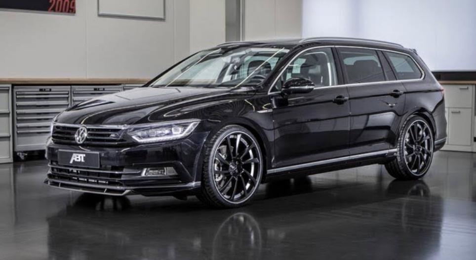

    Thinking about these wheels
    But in 18” size so the current M&S rated tyres fitted on the OEM rims can be reused (they are almost new rubber) there’s a nice clean set available locally second hand.

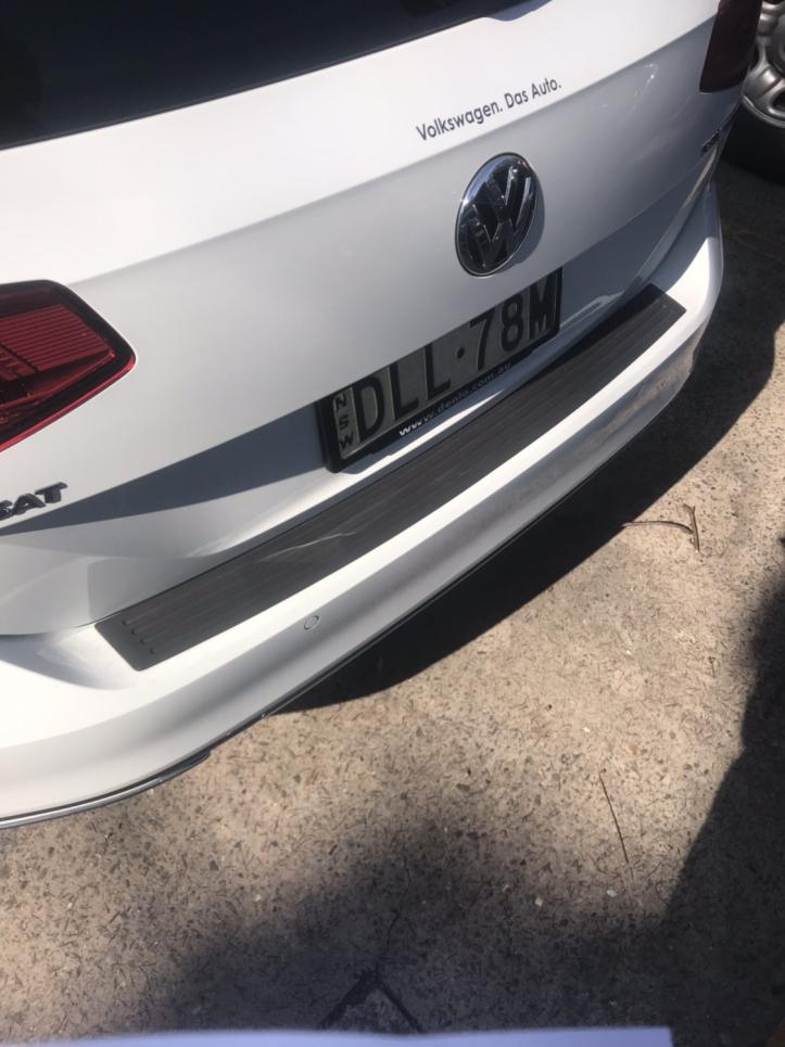

        Is this skid plate a standard dealer part? It’s a nice thick rubber.
          I don’t think so

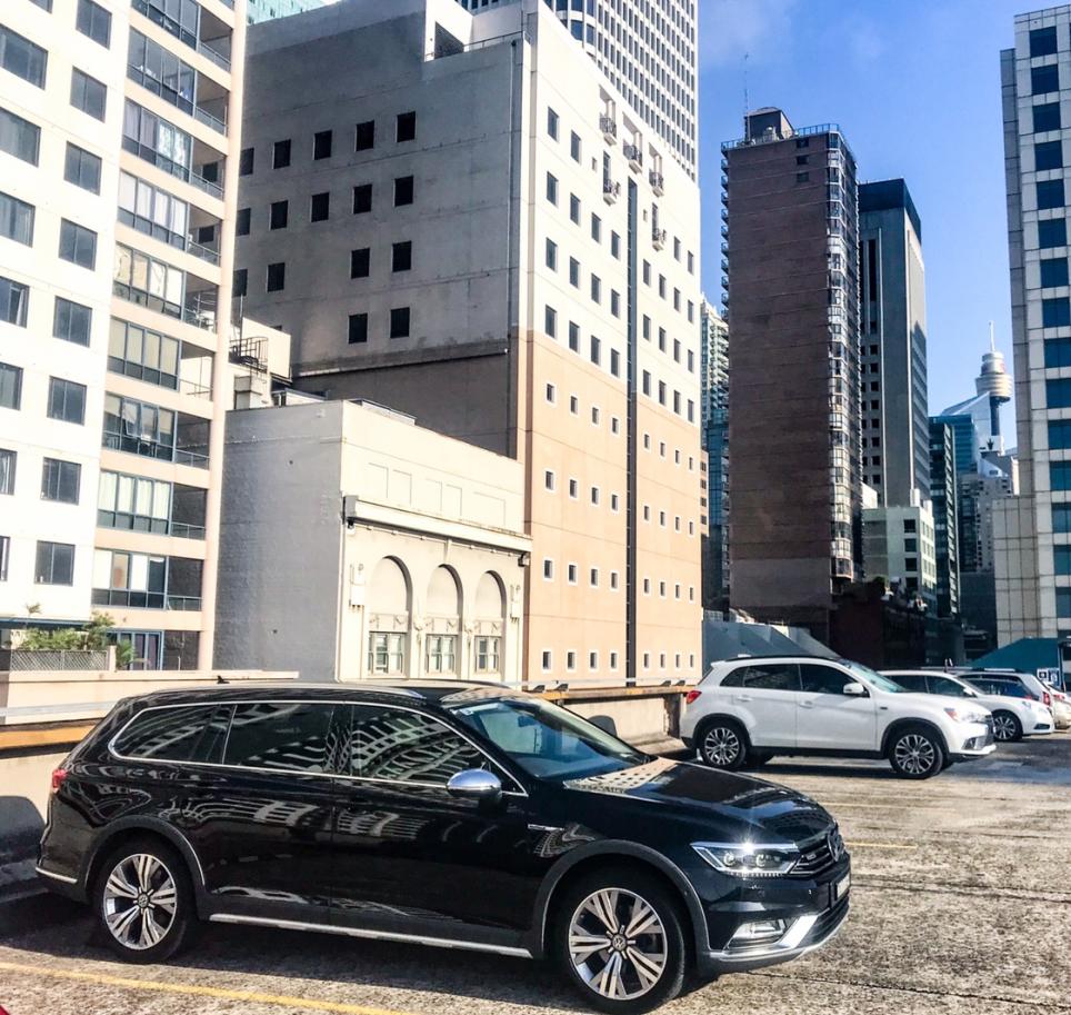

                  Completely non off road pic
                  Nice! I’m in the market for one of these at the moment - how do you find it? If you’re willing to share what you paid I’d love to chat over DM
                  Look forward to seeing what you do with it. I love what you did with your B7!
                            Loving the upgrade from the B7 $36k onroad with 44k on it.
                            Spec’d with the luxury pack and pano roof. (Maybe the same pack)
                            Has the park assist, heated massage memory seats, cornering lights etc.
                            I would have preferred a lighter colour like our old one but this was too good a deal to pass up. Full service history, new tyres at 41k and very clean. There is not a single mark on the wheels, couple of tiny door dings. But the one thing I do miss is the paddle shift.
