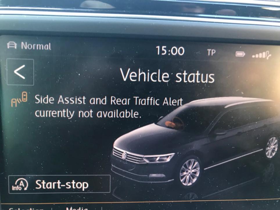

    Hey all.
    Yesterday on the M1 the Side and Rear Assist traffic alert stopped working.
    Got a warning signal and the message on the dash board.
    Since it happened I have tried to get it working but still get the same message.
    Has this happened to anyone else?

    Take it back to the dealer.
    Possible issue with one of the rear radars.

        Check each of the sensors as I had a stone hit the centre of one & the system broke down - might help(?)
          I think the side assist sensors are larger radar units behind the bumper, I don't think they're part of the park sensors which are known to act a little funky when they get dirty.
