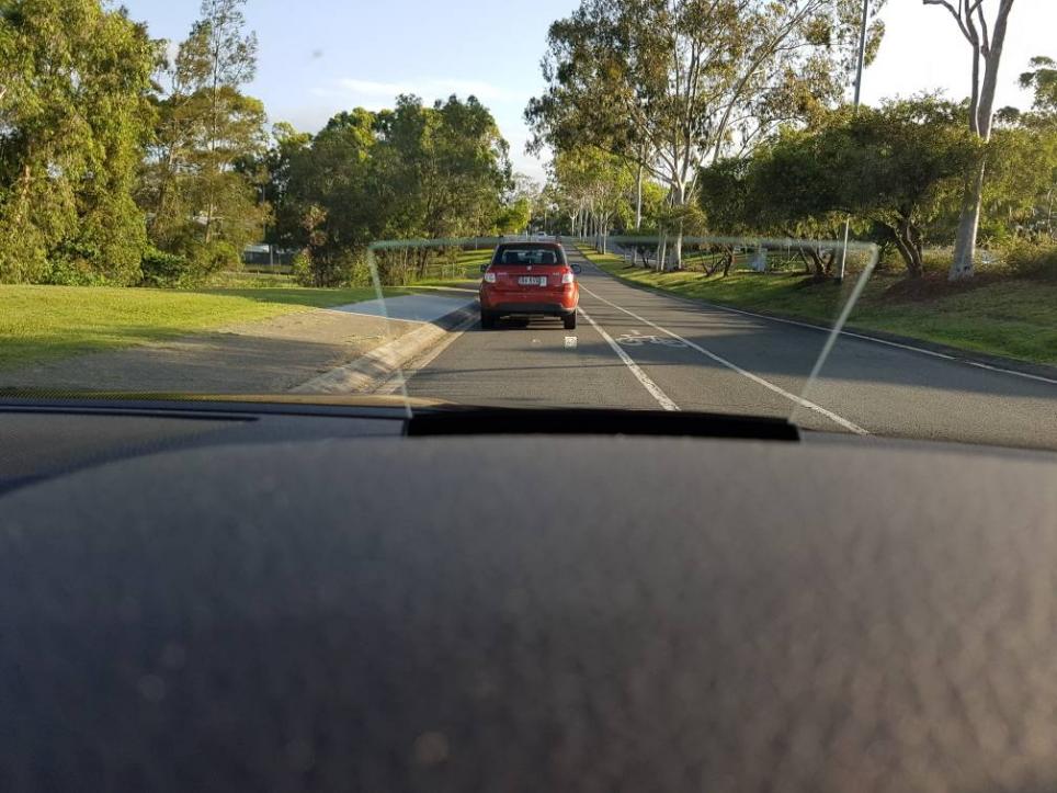

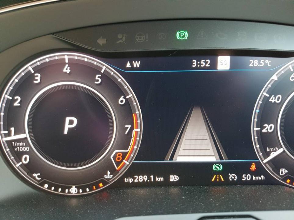

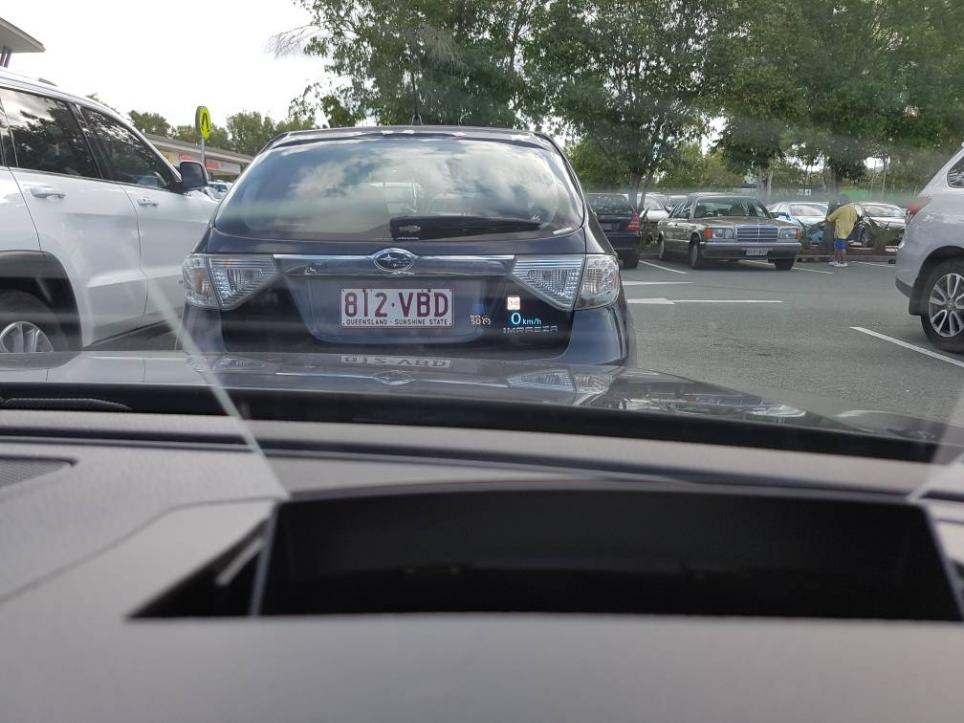

            You guys are juzt too good. Mine was a bit different but got there in the end. Mine has fusion , road and something called horizon to choose from. By the way no warning issues. Only bug is it dont know that its school holiday or outside of school times in 40km zones. Looks much bigger in life and super hd in real life in contrast to the pic. Thanks heaps peps.
