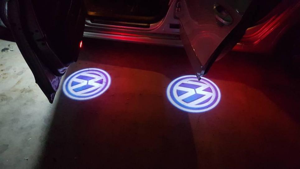

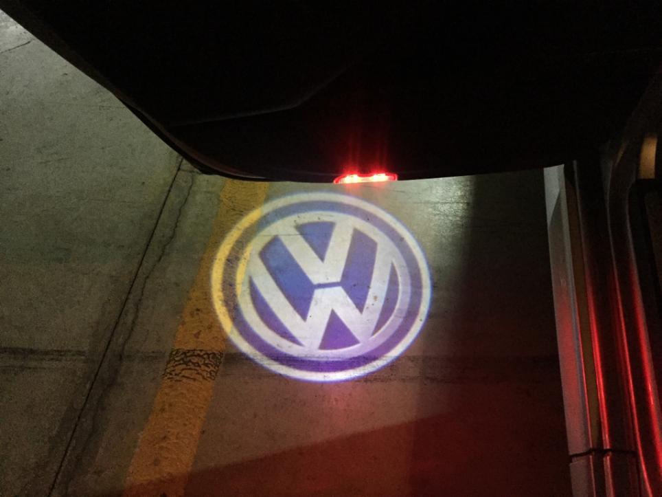

                  So visited Mr Kamold today for some magic VCDS programming and now I have (well one anyway, until I install the other three) a working door courtesy lamp with bonus VW logo/projection puddle. Looks pretty cool if you ask me

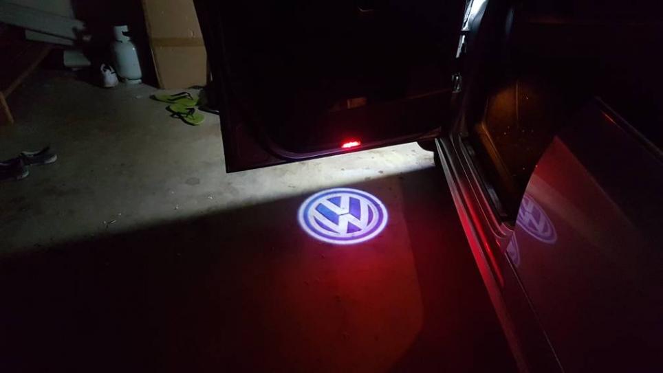

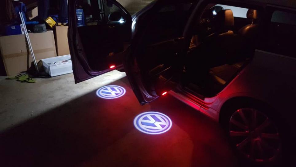

                            Woot! All four working door lights now! Got the second setd of wires in the mail and they fit straight in, even have authentic cloth wrap on the wires which is nice. Pro tip: on the front doors, you unlock all the door clips and simply prop the bottom of the door out with a screwdriver or trim tool as the master connector with the pink clip has a cable long enough to reach around the door so you can pop in the cables and reassemble without having to take the top of the door plate off the window sill and disconnect all the wires and door handle cables. Simply out a tarp down and go in from the bottom. Both front doors took me 10 minutes total to fit! Looks pretty sweet now with all four done and the LED puddle panels on 😁
