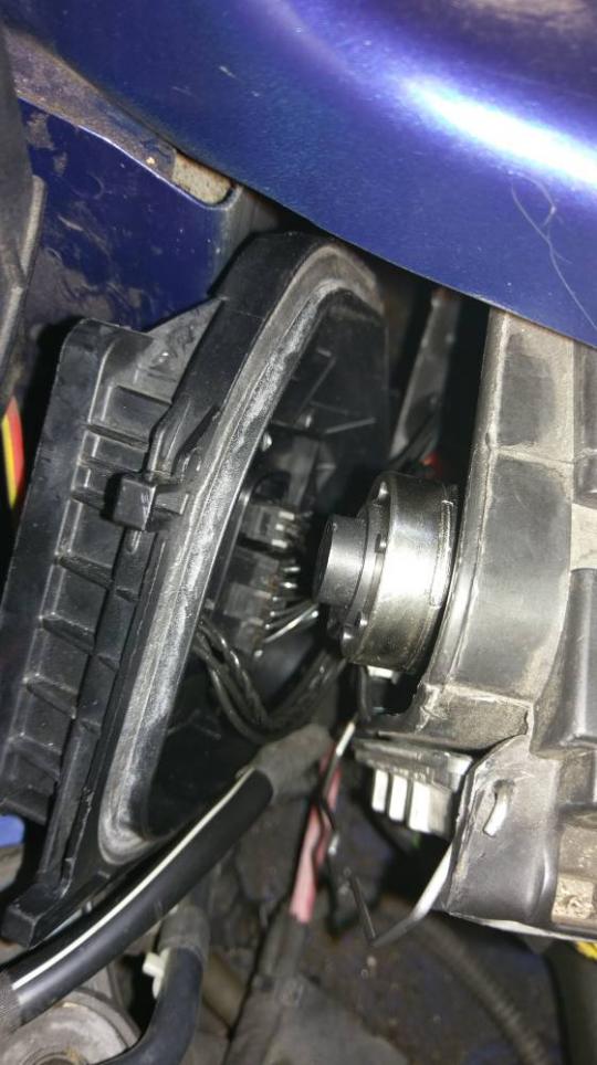

                Passenger side.
                I managed to get the connectors all back on with only minimal swearing and contortion.
                Note that the two smaller connectors are the same. If you plug them into the wrong spot your leveling motors won't work and you'll get an AFS warning in the MFD.

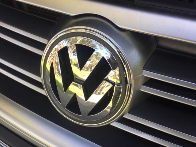

                      Yes please! How much do want for it? And does it come with the dome surround? They are both cracked...
