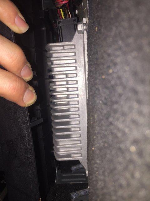

    So I was busy installing my 9WZ Bluetooth module this evening. I was planning on putting it under the passenger seat as from videos online and the length of the wiring harness this seemed to be where is meant to be installed (I could be wrong). Anyway when I looked under the plastic cover down there I found what I can only think is an amp. It has a fairly hefty heat sink around it. Can anyone shed some light?
    Hey, yep looks like the standard amp not the Dynaudio one.

      Thanks. Didn't realise I had an amp at all. If I dont have the black foam bit is there anywhere else I can put the module?
