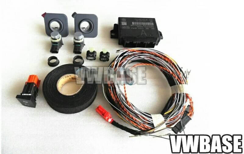

    Hi all I'm having trouble with my park assist install ,I have wired everything up and up to the coding stage .I have 1t0 919 475 m module and vcds can read it but cant do a single code it says -this appears to be an uninitialized control module click yes no or cancel (yes is use default values of 12345 123 12345) I click yes and I get -coding rejected error 31 ?? Has anybody successfully installed pla 1.5 ?

        kit like this one
