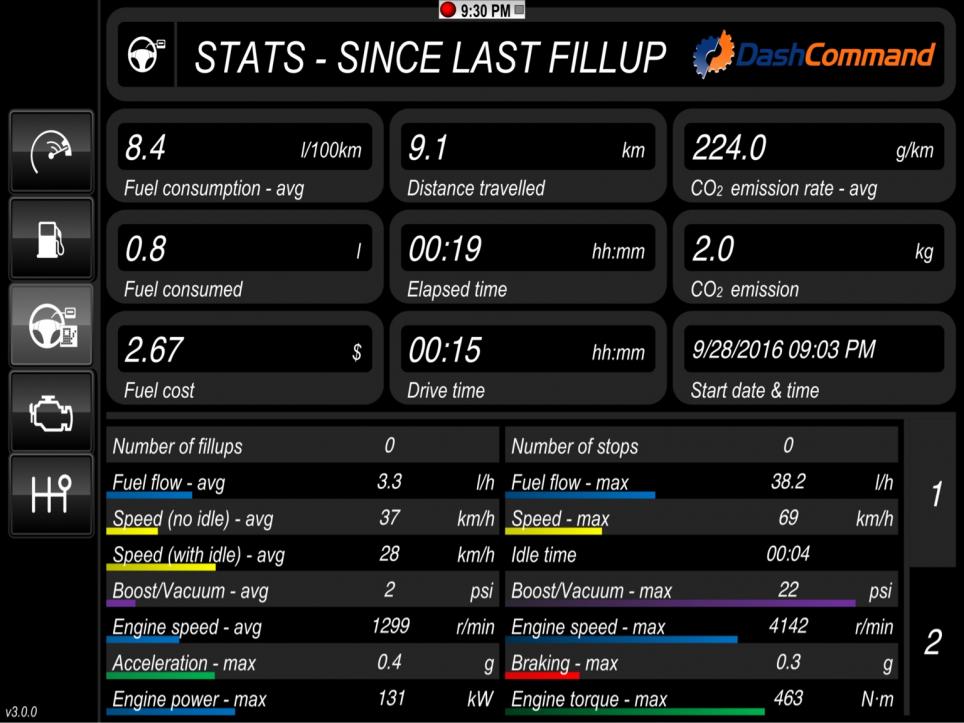

Lastly I bought an elm odb2 wifi dongle to check for any codes and also see how it ran (max kw, torque, boost, etc). I'm not sure how accurate these are but I've tried dashcommand and another 2 other highly reviewed apps and all 3 showed the following maximums:
Power (kW): 131
Power (hp): 176
Torque (N.m): 463
Boost: (psi): 22
I may very well be wrong but I was under the impression that stock is more like 103kw around 12psi and that much torque would have been the end of the dsg. So I'm thinking it's 1 of 3 things.
Power (kW): 131
Power (hp): 176
Torque (N.m): 463
Boost: (psi): 22
