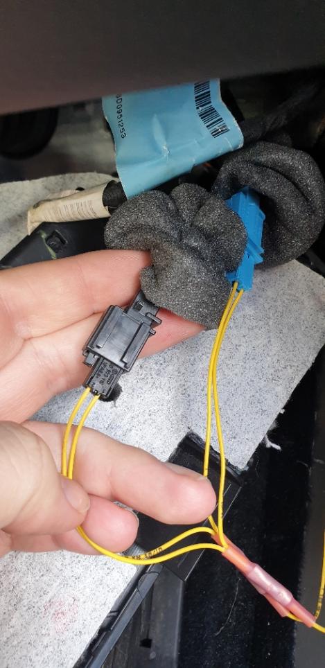

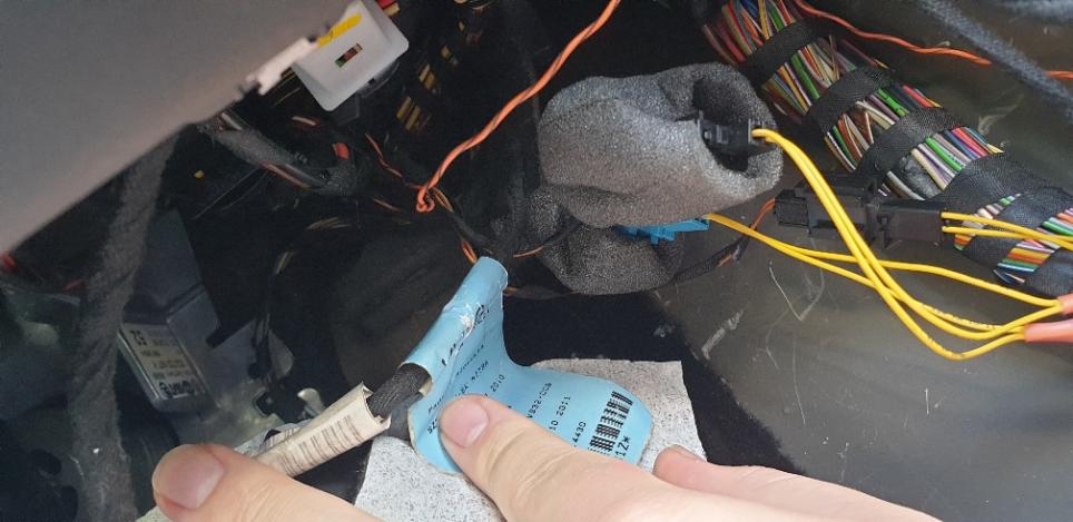

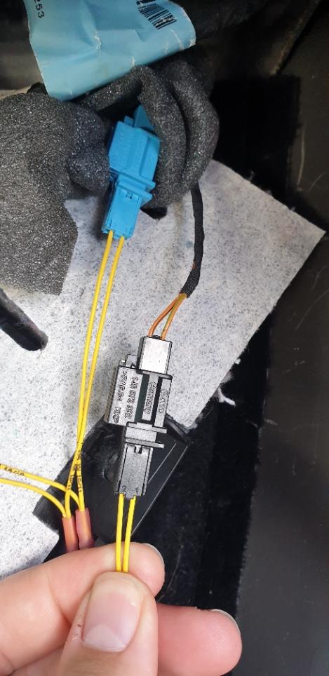

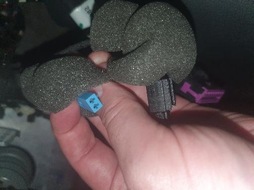

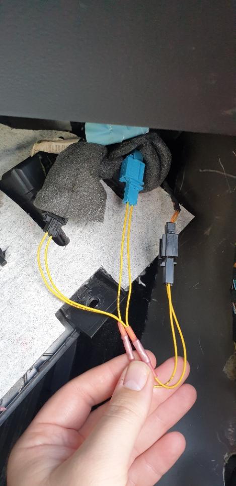

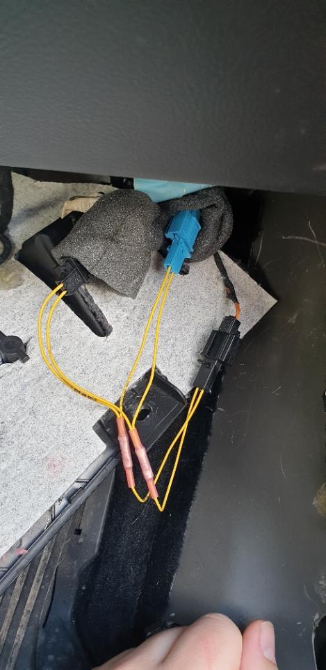

Unfortunately, when I plug it in I get a very dim brake light, and no indicator or tail lights. I'm led to believe that this is due to the trailer module not having power. Fished around under the dash, the connections seem to be in place but there is one plug that doesn't seem to have a home, and I can't find it's mate. No fuses blown that I know of (although I haven't checked since I did the coding)
