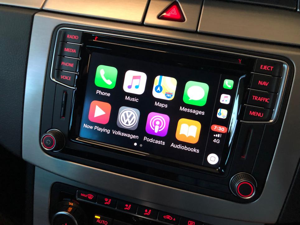

                  I recommend you talk to kamold about retrofitting a Discovery Media unit.

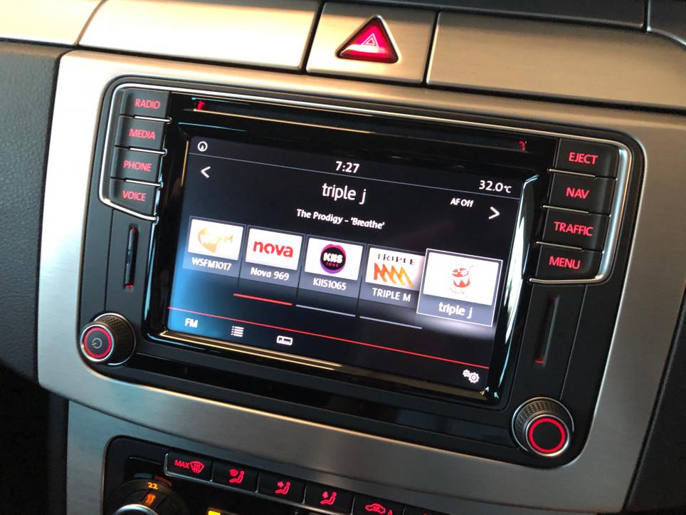

                  Some pics of mine installed:

                    Ooh I like that.
                    You've got steering wheel control for that unit too ya??
                    captain courteous enjoys vag
                      Yes. Works a treat. Highly recommended.
                      MY10.5 R36 Wagon | Icelandic Grey | rrr36r on Instagram
                      MY11 Golf R | Rising Blue | vwmk6r on Instagram
                        Yeah, that Discovery Media unit looks the goods - nice work.

                            Love that track. RIP Keith
                              That looks awesome..
                              How much did that cost?? Was it easy to fit?
