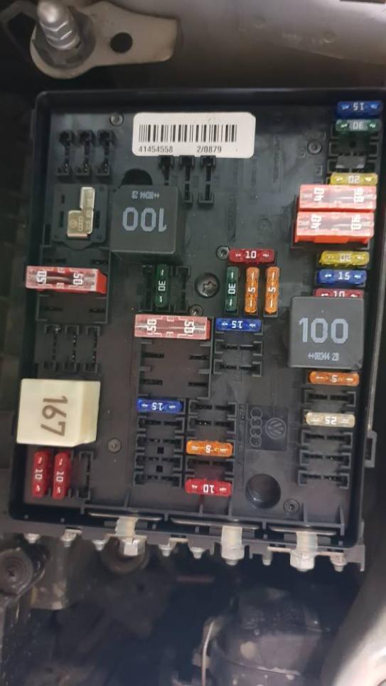

    I did some dumb stuff, and pulled out some fuses in the underhood fuse box, dropped one inside the engine bay, replaced it with a spare fuse, have absolutely no recollection whether I did something else stupid, and now my check-engine light is permanently on, throwing a P0030 and P0050 error (heated oxygen sensors, both sides)
    I'm thinking I must have done something silly with a fuse, and have something in the wrong spot, but these fuses are not in the owners manual.
    Can someone take a photo of their fuse box and share it with me so I can cross check, please!
    Here's mine for reference.

    Here you go Simo, mines an R36 wagon 2008 model with no sunroof or powered tailgate.
    Sent from my SM-G960F using Tapatalk
      No guarantees mine are correct ratings but I haven't had any issues with any errors in obd2

        difference

          Thanks team!
          Some resources say fuse 33 is unassigned, others say lambda probe, so could be the one!
          I'll let you know how I go
          UPDATE - two days in, and the engine light is still off - looks like a win! Thanks everyone ��
