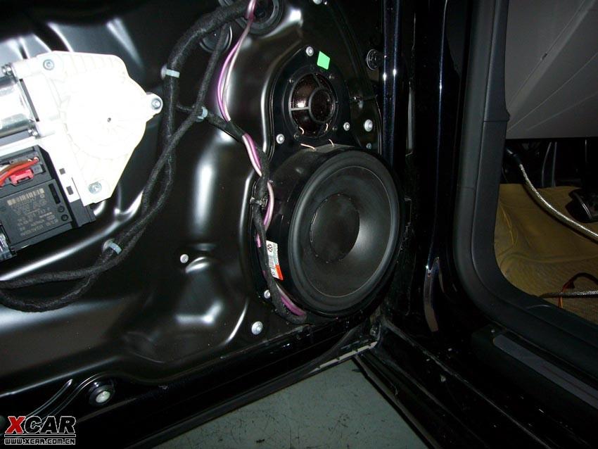

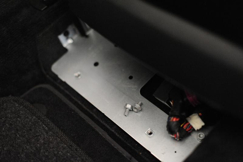

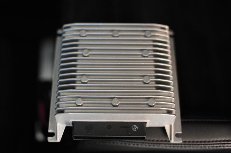

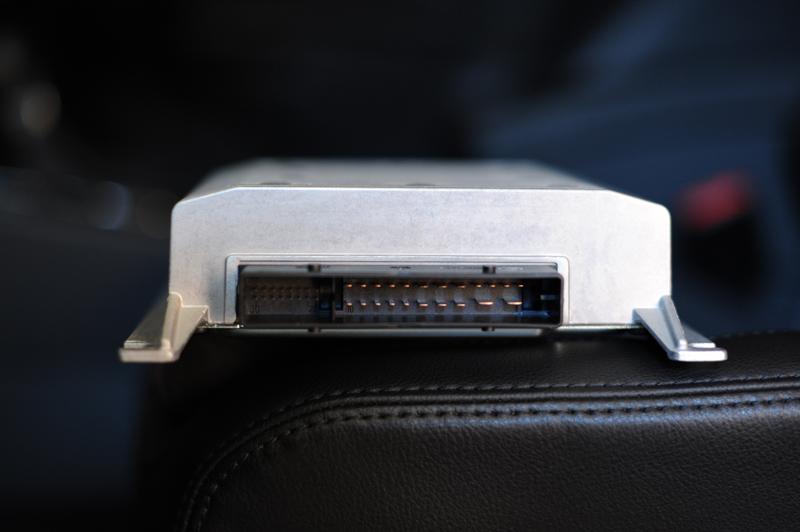

    I had a chance to have a look at the standard amplifier in my MY10 R36 Wagon and took some photos.
    Unfortunately, the Dynaudio Retrofit (Plug and Play, done by member nermal on 2008 R36) wont work me. Another member
    Timlin had trouble to plug in his Dynaudio Amp as the plugs are different on his (2009?) R36.
    So it looks like VW changed amp wiring design between model years. Maybe VW did not want people retrofit the optional Dynaudio. The change probably happened when VW updated the cluster. This may also explain why he Dynaudio Retrofit Kit comes the wiring looms(due to the plug change).
    For 2008 R36 owers, they are lucky as Dynaudio is plug and play.
    For 2009 and 2010 R36 owners, Dynaudio Retrofit isn't an easy job at all. Dynaudio Retrofit wont be on my mod list anymore. I will be just getting used to the standard system.
    Here are the photos I took, note that the amp is square shape which is different to Dynaudio amp.
    Part Number 5K0 035 456

        Wow... this is bad news. I've just invested a reasonable amount of money on the new Dynaudio amp and as stated above, I have the long black multi-pin plug and the Dynaudio have what looks like two smaller grey plugs.
        The OEM amp is ok, just, but the Dynaudio amp is quite amazing, so its begging to be upgraded.
        ****... An adapter is technically possible, but the parts would be very hard to source.
        Plus, the OEM amp says 8 x channels and the Dynaudio amp is 10 x channels. Does anyone know what the two extra channels are for?

          Adapter may be possible but there is no room to put the adapter...
