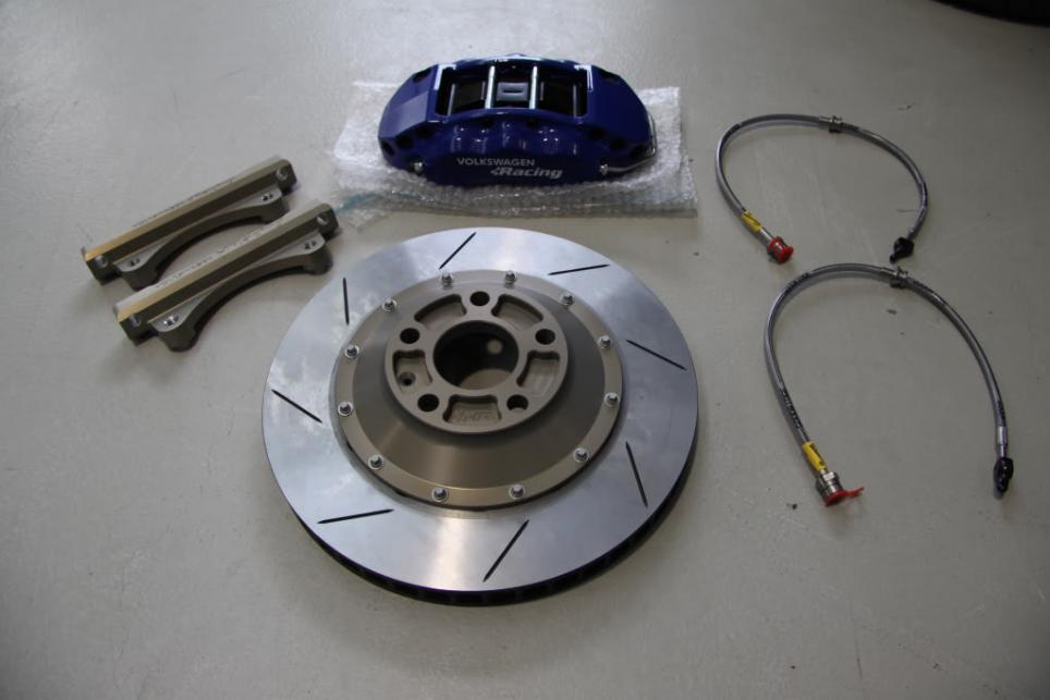

    Hi All
    Im getting a BBK on my 2009 R36 wagon, and I'm torn between the Brembo 6 pot system with a 355mm drilled disc, or the VWR version with the 332mm drilled discs...
    I'm not really concerned about price, I 'm just curious what folks thoughts were - stay original VW/R or go with a famous brand?

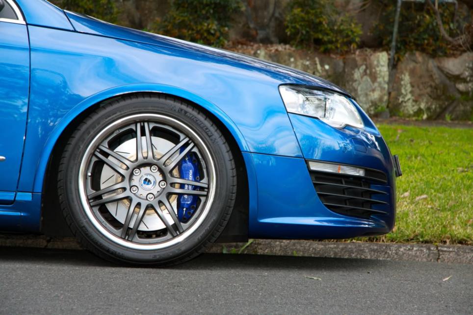

                    Gonna go with the VWR kit. Plus, they've just released a two piece rear BBK disc that matches the front slotted discs too.
                    So the car will have the 2 piece rotors all 'round. It added $1k to the upgrade, but if you're gonna do something, do right and do it once.
                    Parts arrive in a month, I'll post some pics when done...
