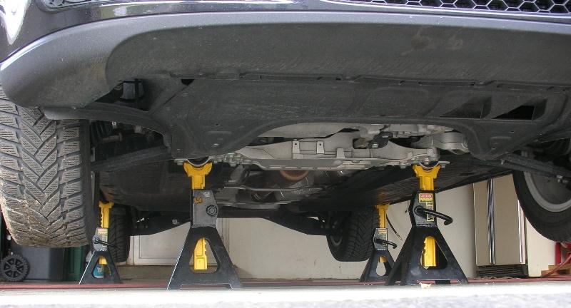

                            Cant believe the Chermans didnt design the car with a F&R central jack point... So you have to jack the car from the side and put your cars stands under the front subrame... Crazy... Found this pic:
                            The V's in my jack stands didnt fit the control arm very well, so I placed a heap of timber under the sills (just in case...)
                            I might invest in a oil extraction pump or some ramps next time to make things easier... And to buy a fumoto oil drain valve to save buying new sump plugs every time i do an oil change...
                            My BMW is much better has a great central jack point, trap door in the plastic undertray to access the sump plug (saves removing the whole entire tray)
