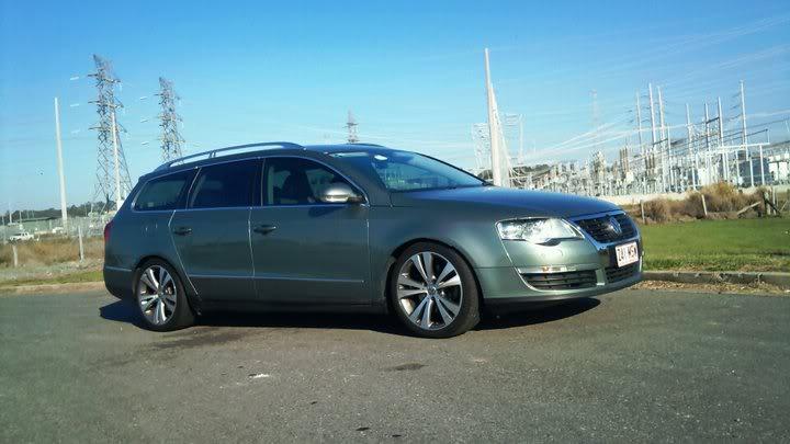

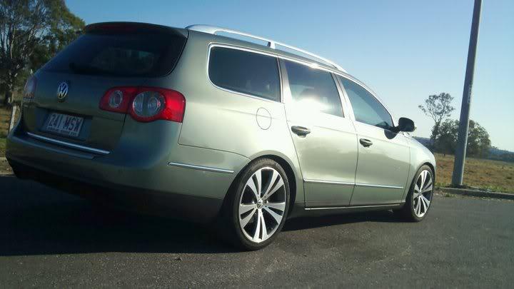

So our B6 is 4 years old now, I thought I'd share with the forum members on our experience during this time and perhaps some people looking for a used passat may find this useful as well.
It's a June built '06 model, '07 model year 2.0TFSI wagon. It was optioned with 18" with sport springs and xenon. Upon delivery my mother also added 2 tone leather seats, oettinger remap, MFD2 and the Skoda 729B BT kit.
Recently my mother got a new (impractical) car, but still wanted access to a large car when she needed. So I gave my Caddy to my younger brother and bought this from her. The sport springs on normal shocks gave a very bad handling / ride package so I sourced the H&R kit from ECS Tuning for 800USD. Bargain
