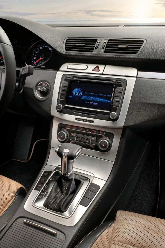

          I presume you have the new climate control which is the same as the GOLF now. Not sure if you are aware, but there is a LOW and HIGH Auto option. if you don't want it to blast you use the LOW Auto option, probably best to refer to user manual.
            No R36 has those HVAC controls. (thankfully - cause they're crap compared to the old style)
              All MY10 R36 have them. I have had the MY09 and now the MY10, the new design I personally think is better. it's also fully integrated in with the RCD510, so any changes made on the controller are also displayed on RCD510.
              OLD Climate control:
              NEW Climate Control:
                            That old climate control pic is NOT an R36. And if the new pic is, then it looks ridiculous! The shifter is wrong and the HVAC controls look cheap and tacky. And I'm not even going to mention the spew worthy seats that aren't even alcantara! Looks more like a CC interior to me, with the R36 metalic dash trim.
                            This is WAY nicer! And 5 temp settings for the heated seats too.
