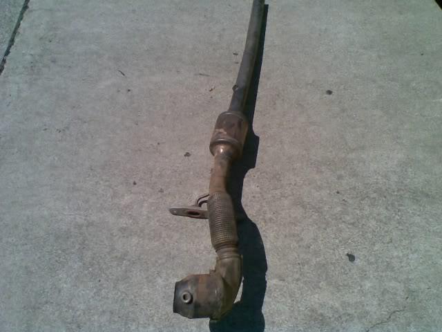

I diagnosed an 06 Passat 2.0T a while back for a blowing exhaust, found to be the flange at the turbo sheared off, this i thought was a one off, so i checked with VW parts to verify this by asking how many they had sold in the year, mines was the 1st so pretty much put it down to a flaw one off. Just looked at another today and yep clean shear at the turbo. Not so much of a one off now. Will be keeping a close eye on them now, if you caught it in time you could remove the section and yeah its a bit of a pain but would save you in the long run with a nice seam weld before disaster.
