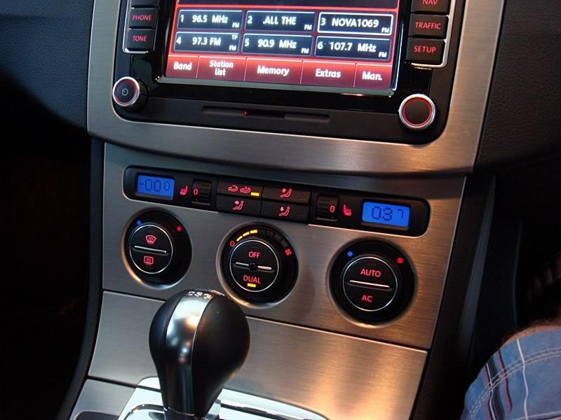

    Has anyone else found the data menu the service guys use to read values on the ECU? The saleman showed us when we picked the car up. Its pretty cool but I only know what what one of the readouts is actually measuring. (#19 - Actual speed)
    It would be good to find out what the rest are as I imagine they will be things like water and oil temp etc.

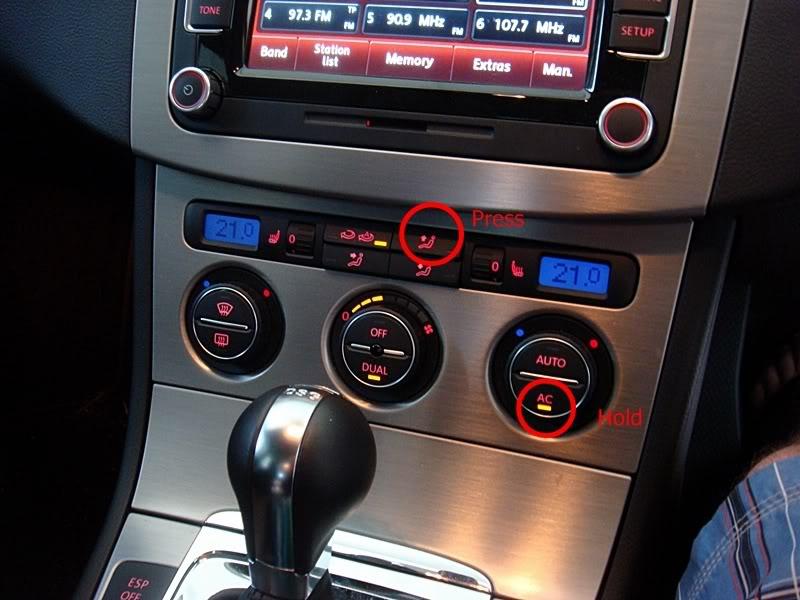

    The menu is found using the climate control.
    1: hold the AC button down and press the other circled button once
    2: the screens will change to this

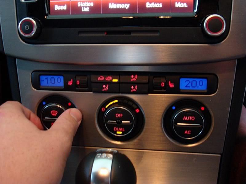

    3: use the left dial to cycle through the menu. There are 31 different sections.

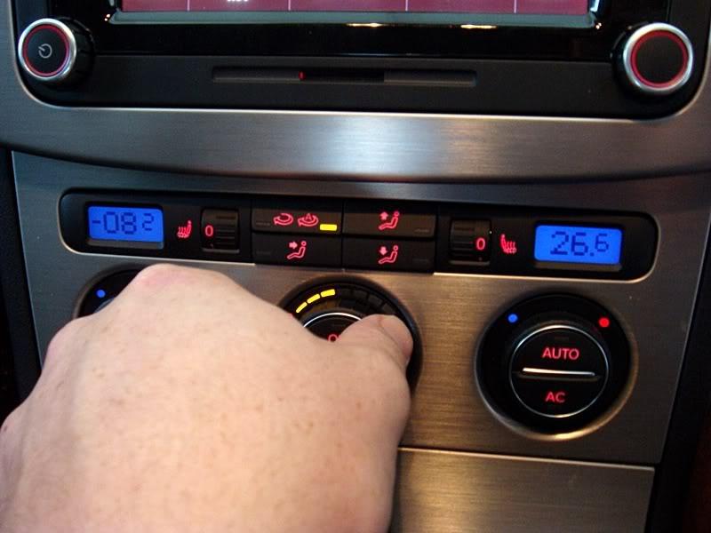

    4: within each section there are a number of sub sections which are accessed using the centre dial

    I'm guessing the sub sections are showing the speed for example in Km/h as well as mph or something like that. Would be great to know for sure though.
    It's amazing just how far out the speedo is. If the Climate Control speed display is accurate of course.
