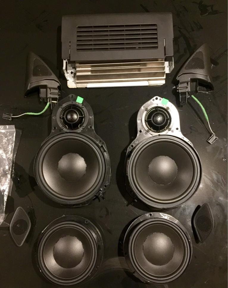

                          I've got some pics of the dynaudio gear from a CC which I'll post up soon for you to check out
                            I have already purchased it, but I sent the guy an email to cancel... I'm really disappointed... I thought I have finally found a Dynaudio system to fit... The seller said it is a Dynaudio system for CC and Passat B7

                              Maybe he got his photos mixed up, CC Dynaudio looks like the below. That listing and amp part number defiantly isn't it.
                              Second pic is the amp part number
