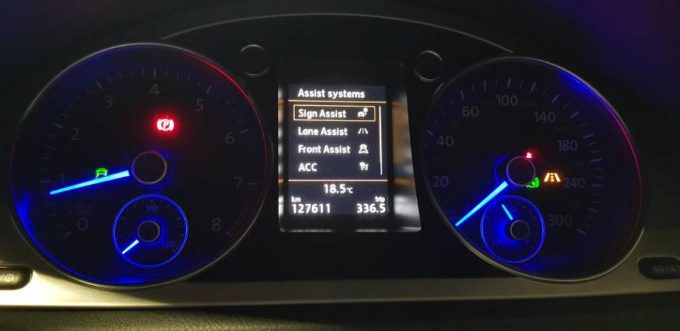

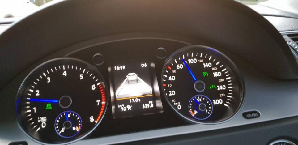

        Installed and working.
        Just waiting on new trim pieces to cover it all up.

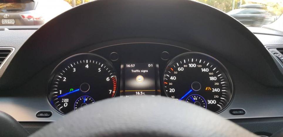

          Traffic signs work with the Australian map? I thought functionality would be limited again. Is it because it’s a camera from European vehicle?
          • #20
            It gives an error saying limited but it works fine.
