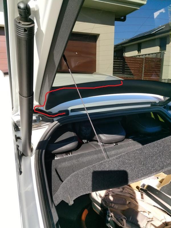

              Here is my issue with the back and why I was looking for inspiration from other Arteon owners.
              I can't get a great picture of the inside but I'm considering running it along to floor...

                If that were my car I'd be popping trim off and following this path...
                  That is definitely the route I wanted to take, but it was more hassle than it is worth. From what I can tell, tt involved removing the a seat. I'll post up pictures of how I managed to install it.
                  Arteon & T-Roc
                    The seat? WTF? No. How does that red line go anywhere near a seat? It's just plastic trim to un-clip! You don't even need to fully remove it. There's a piece on the boot lid to pull off, a piece on the underside of the roof, the rubber boot as seen in the photo and then you simply run it around the edge of the headlining.

                      As for the rear camera, run it under the roof line to the cable grommet in the boot hatch, then run it along the trim inside the hatch until you mount the camera.
