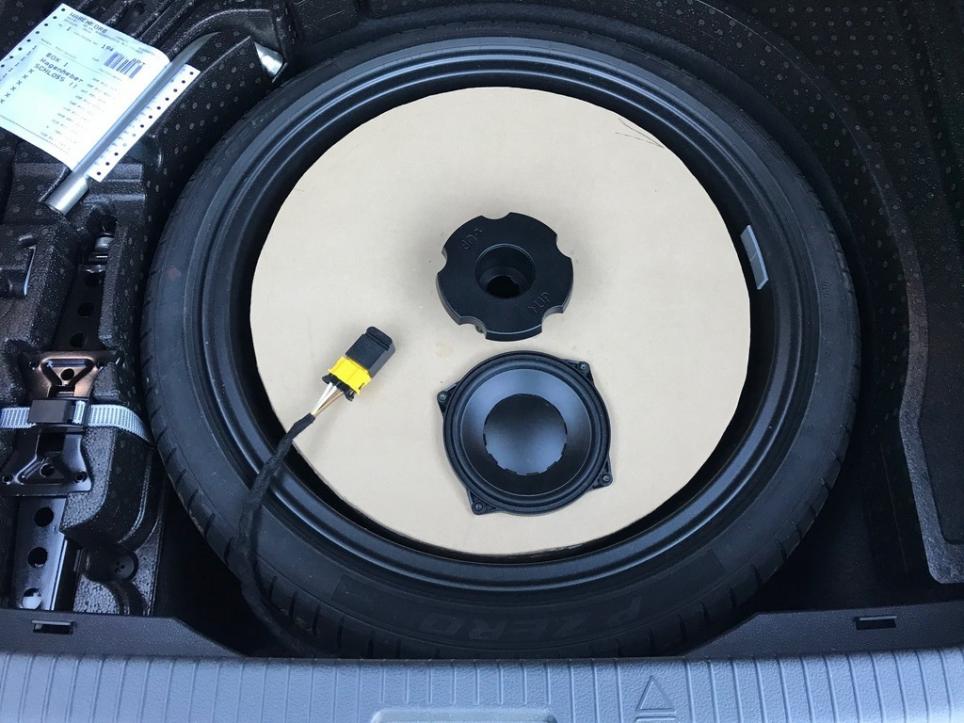

 Originally posted by DAS AUTO View PostThanks Guys, great insight. I definitely agree on the subjective nature of the listening audience. It's interesting too how my tastes have changed as I've gotten older.
 I'm going to go back to 'authentic' and give that a go. I'm sure I can find that sweet spot.
 I have something else in the works to address the levels of sound in the 30 - 150 Hz range......stay tuned

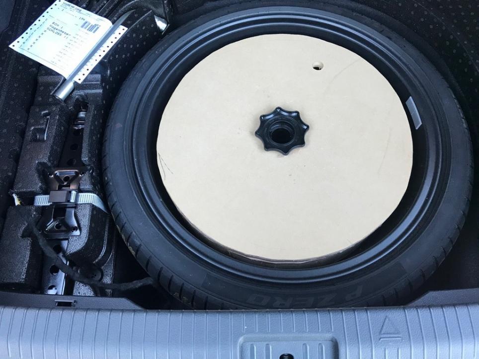

 Had to break out some old "Kerfing" skills to create the round enclosure.
 Dropped in the factory Dyn sub while I'm waiting for the Kicker to arrive from 'merica...Noticeable difference with just a larger enclosure - 18.7 litres. Much better lows and bigger output.
 Stage 2 next weekend fingers crossed
 I'll admit it... I had to google 'Kerfing'... I've only ever built square sub-boxes.. I'm assuming the 18 litre enclosure sits within the design perimeters for the subwoofer you're ordering- are you matching the ohms and watts rating to what's provided for the factory unit or are you amplifying as well?
 Yeah the sub that’s coming has a recommended enclosure volume range from 5 to 21 litres. I’ve gone with the dual 2 ohm voice coil unit to be the same as the factory Dynaudio sub so as to retain the factory amp.Originally posted by LRDV8R View PostI'll admit it... I had to google 'Kerfing'... I've only ever built square sub-boxes.. I'm assuming the 18 litre enclosure sits within the design perimeters for the subwoofer you're ordering- are you matching the ohms and watts rating to what's provided for the factory unit or are you amplifying as well?
 Not sure on the max power output of the Dynaudio amp but it think it’ll be plenty.
 Overall plan is to keep the car as close to stock as possible so that I can reverse any changes and keep full use of the spare tire and boot space. In my younger years running 2 gauge down a car to power a multiple amp racks and 12 inch subs would be a given...hopefully my current plans will be enough for a little while.
