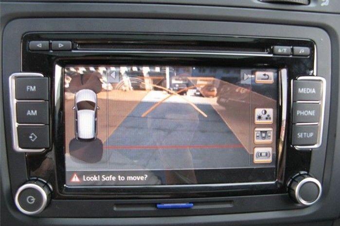

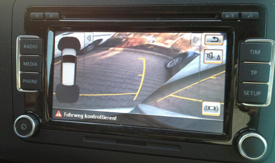

    Page 222 - How do I get the reverse camera to also show sensor graphic like this:
    or this
    I can choose camera or sensor view, but not both at once.
    - The arrow should be on the edge of the LCD screen on top left corner, it should open up. Have modified your pic as below

      Thanks for the reply. Got the reverse camera working, but can't get the passenger side mirror to dip when I reverse. Roof buttons dial what looks like a German number so I'll ask about this at the next service if I can remember / be bothered asking.
