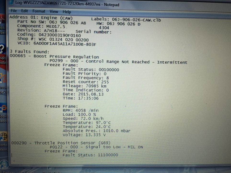

    Hi, my wife came home this afternoon telling me the car had no acceleration.
    i turned it on and it started vibrating and engine was struggling.
    I also noticed it had no oil. Could this be the problem?
    I run a diagnostic scan and this is what came up:
    MY10 Tiguan 125TSI /APR Stage 2
    I'd be looking at the faults that occurred yesterday. There's several errors that were earlier in the vehicle history. Sorry can't be much more help but I'd be looking at the throttle position error as a start. Have you changed/upgraded the accelerator pedal?

      Yeah, have a look at the throttle pedal checked out. Abit strange to have both senders throw faults as the internal circuits and external wiring are separate from each other.

                Clear the faults out. And see what comes back. Google any fault codes and see what the Ross tech wiki says. Control pressure not reached could be a boost pipe off. E u sees lots of air go into engine, but most gets blown overboard. Codes in abs and auto are due to engine faults so ignore them for now.

                        Clear the faults and start it up again to see what's still there. Might need the throttle body aligning?
                        Did you take out the sprint booster with the ignition on?
                        What did the ross tech wiki tell you to look at?
                          i think it might be throttle body.EPC light is on.Took out the sprint booster with car off and changed the coil pack.Will need to find out have to do a throttle body alignment with ross tech cable.
