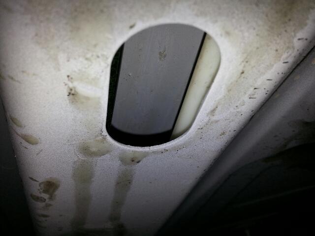

    Solution.. take the underbody plastic panel out and press some softform through the elliptical hole to keep fuel line from vibrating. Viola! Now no more nasty rattles and I can enjoy sports mode agin

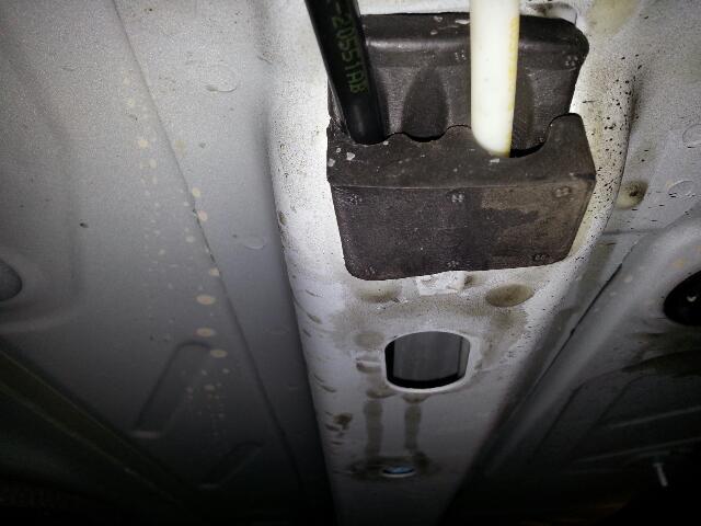

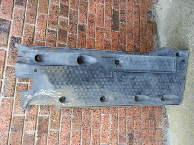

    Under body plastic cover removed
    Fuel lines go through this channel caused the rattle
    Elliptical hole used to pressed soft foam in.
