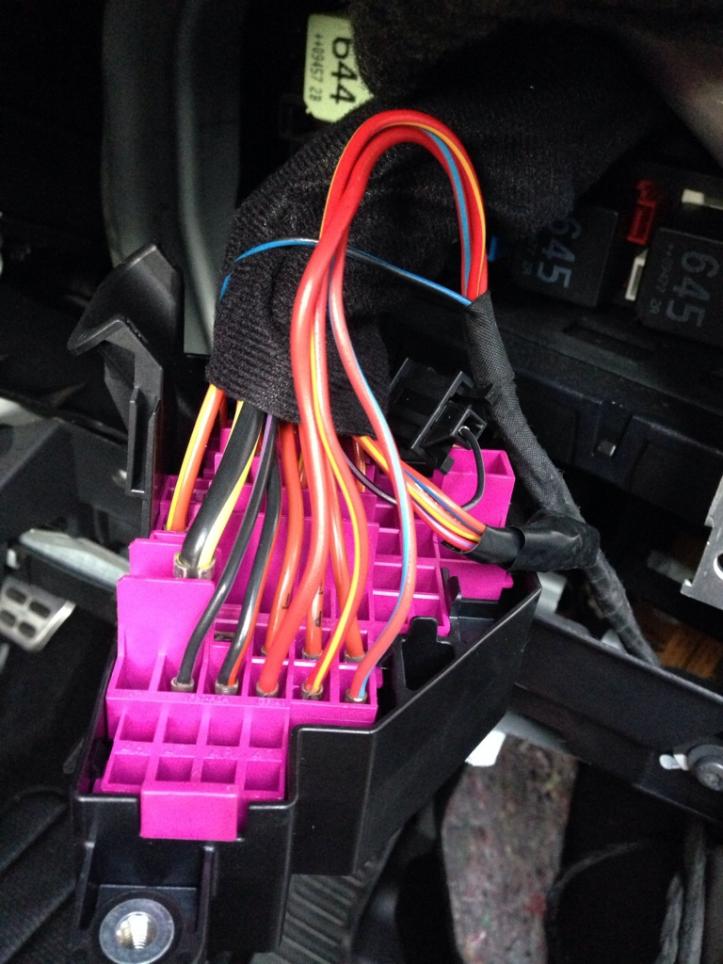

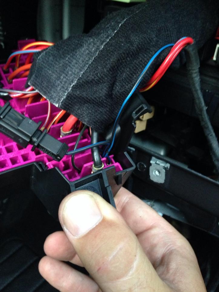

                    Trailer pre-wiring AUS Delivered Tiguan
                    Slightly off topic, but seeing we have knowledge-able chaps like Umai Naa!! and vdubmotorworx in here - do either of you have details on the VCDS changes that need to be altered when adding a towbar?
                    As mentioned a few posts above, i am currently removing a BestBars (VW "OEM") towbar from my 2010 MK6 GTI. I have removed everything except for the few wires going into the CECM and also the fuse panel under the dash. Once i have those out - the removal will be complete. I would like to "undo" any VCDS changes that were altered to accomodate the towbar operation to avoid any errors.
                    In addition, i am planning to re-fit this towbar to another forum members Mk6 118TSI, and would like to know the VCDS changes to alter on his car too.
                    PS - here is the wiring into my fuse panel. The installer (Kloster VW in Newcastle i presume as thats where the car was bought new) removed the stock wires (popped the pins out and taped them up) and replaced with new pins for the new towbar specific wiring loom. Same goes with the wires into the CECM.
                    • #25
                      You need to get hold of the correct terminal pin tool to release the wires out of the connectors. That pink section of the connector slides sideways to "unlock" the terminals, then you use the tool release and push the terminal out.
                      With regards to the coding, go into the gateway, then into coding, and it's simply a case of selecting or deselecting the trailer electrics.

                      • #26
                        Comparing Golf VI to early Tiguan is like chalk and cheese with the wiring. Two different setups. Tiguan is much like Golf V. CANbus wires on the Golf VI go directly into the BCM.
                        Thanks for the details Umai Naa!! - thats what i was hoping for. I have the pin tool, but was not aware the pink bit moves over to unlock the pins....probably the reason why i hadnt been able to get the pins out. I'll try again in the morning.
                        • #27
                          The pins can be quite tricky to remove some times in that front fuse box.
                          VOLKSWAGEN TECHNICIAN - 16 YEARS OF PAIN..
                          VCDS CODING- FAULT DIAGNOSIS - PRE PURCHASE INSPECTIONS- REPAIRS
                          9W2 BT KITS -$300 - 9W7 BT KITS - $450 - CANBUS UPGRADE $150
                          BRISBANE / GOLD COAST
                          • #28
                            Indeed they were - a real pain, but i got them in the end. Towbar is now removed and i fitted it to another Golf today.
