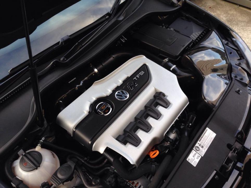

                        I think I would be in the OCD category... i check my dip stick so often and even wipe n keep my engine bay clean. At one point i saw someone else's car engine bay n it had dust. I wondered how that is possible!

                          Tiguan 132 TSi Engine Oil Low
                          +1 here. This is how it looks all day every day.
                            Sent from my GT-I9300T using Tapatalk
                            Nothing wrong with keeping things clean. Makes it easier to spot any problems before the become an issue.
