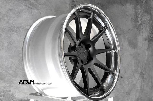

                  Cheers Naresh, yeah not a fan of that pushed in look flush with the guards is the way to go. I have 19" 235/35/19 et45 on my Audi A4 and the wheels sit flush with the guards..thought might be same with the tig... So in the future when looking for rims for the Tig I would go no bigger then 19" but would like the fats like 255,265 even if its on the back only but go with the smaller profile and smallest et. Would love the staggered look with concave like these but 5+ k on wheels is just not in my ball game
