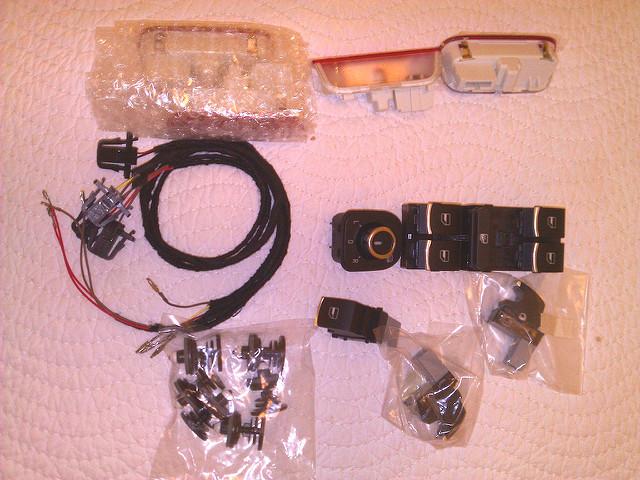

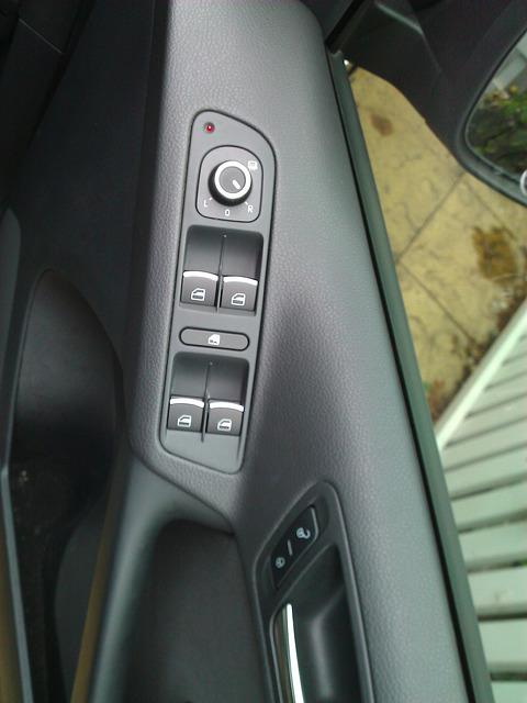

OK This weekends project arrived a couple of days ago - door bling. Well perhaps a little more toned down than the other door bling that didn't quite make it onto the car. More like putting all the OEM bits back on which got taken off for cost savings measures.

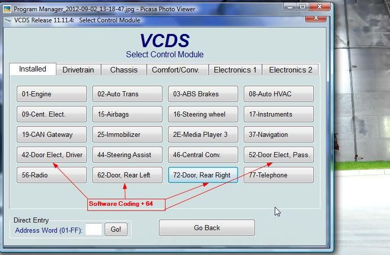

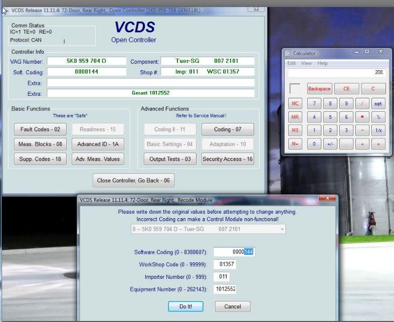

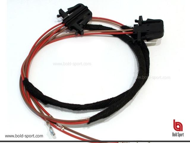

Apparently (and I'll find out soon enough) the connections are already in the door to plug the connector for the lights into and all that is needed is to code them up.
