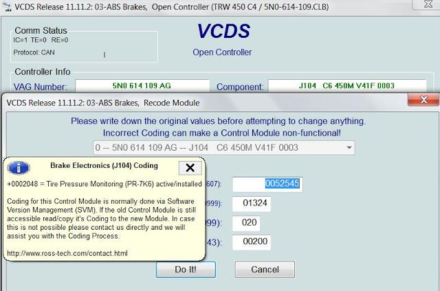

        I have Tiguan with the TPMS and my daughter has the 2012 Model without it, I will check during the weekend if it's do-able or not and let you know.

            I quickly scanned the controllers and they're all the same in 2012 and 2010 models. The 2012 has different style coding but VCDS allows to change (add) TPMS, just need to change the code that is suggested there and hope it works. I've had a busy weekend and the car had to leave at 18:00, so I didn't have enough time to try it, but will attempt it next weekend.
              So this might work without any other mods?
                It looks like it could, and also adding the reset button shouldn't be a problem. I checked the wiring diagram from MK5 Golf and 2011Passat, the reset button is easy to add on, but resetting with VCDS is not that difficult and without the need to spend money on the button.
