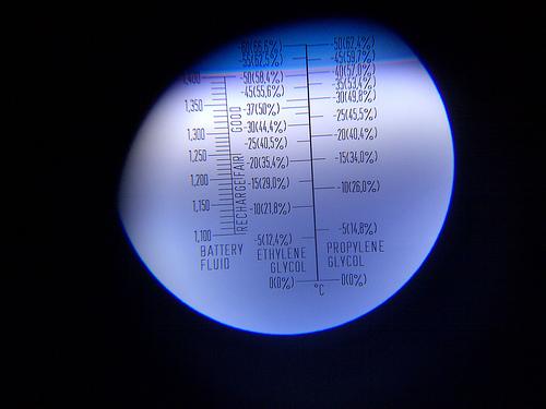

                  I always use 50%.
                  As a matter of interest how is the percentage measured?
                  A hydrometer, electronic device or something else.
                  MY21 Tiguan 162 TSI Elegance Night Shade Blue 7sp DSG
                  • #99

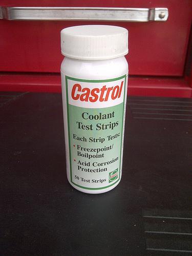

                    I use refractometer and the coolant test strips.
                    Looking into the refractometer (sorry about the picture quality it was taken with my phone)

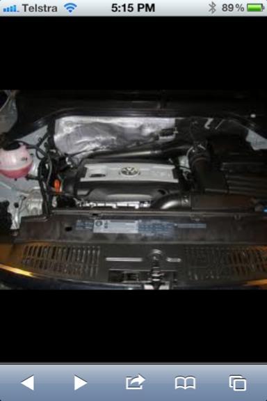

                          • I took my car to European Autotech to have my engine oil changed and stage 1 APR tuned applied. Too their credit they identified water dripping onto the ECU casing. They showed me the water and I too was concerned. On the day I took it in, it was raining constantly on my one hour drive there.
                            (not my engine bay)
                            For those who don't know as I didn't, the ECU is located behind the silver coloured mesh at the back beneath the windscreen.
                            At European Autotech's suggestion I took it to a VW dealer to have it inspected under warranty. I was informed that they tested it and couldn't find a leak. The service manager informed me that a small amount of water is designed to overflow into this area and has holes to allow drainage.
                            My question, is water meant to be in this area. It seems unusual to me, especially given the ECU is located in this area.
                            Finally, I can't recommended European Autotech enough. Very professional staff and shop. If you live in Sydney and don't want to use a dealer and can make it to Mona Vale give them a try.
                            • ^^^ anyone know??? ^^^
                              • No harm done, the ECU is sealed and no water can enter the inside of it.
