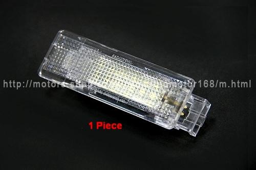

                          FWIW, highly recommend these as potentially lighting up the rear:
                          VW Passat Golf 6 Polo error free LED license plate lamp | eBay
                          These are super bright and without any blue tinge. So are probably 5000K or closest to pure white.

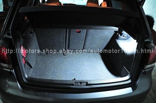

                          Here's one I bought off them, but for the boot (i.e. whole complete unit swapover):
                          Other pics taken from their store:
                          Nothing comes close to these! And trust me ... I've tried a few already.
                          But just need to double check with them whether their current listing will fit a Tiguan (as not listed).
                          They might just be out of stock at the moment.

                            I would fit something like these, since the small LED designed for the interior will most likely not sufficiently illuminate the space behind the car.

                              Thanks Transporter I may try to fit some of these under the bumper and connect to reversing light. Aussietig are you suggesting I open the boot to see when I reverse?
